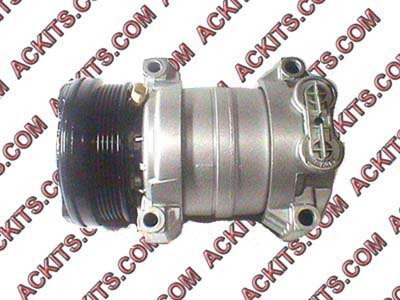

If Everco uses a Harrison H6 compressor:

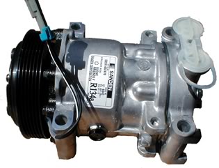

the GM clutch will fit. If Everco uses a Sanden compressor:

or some other brand compressor:

the GM clutch probably will not fit.
