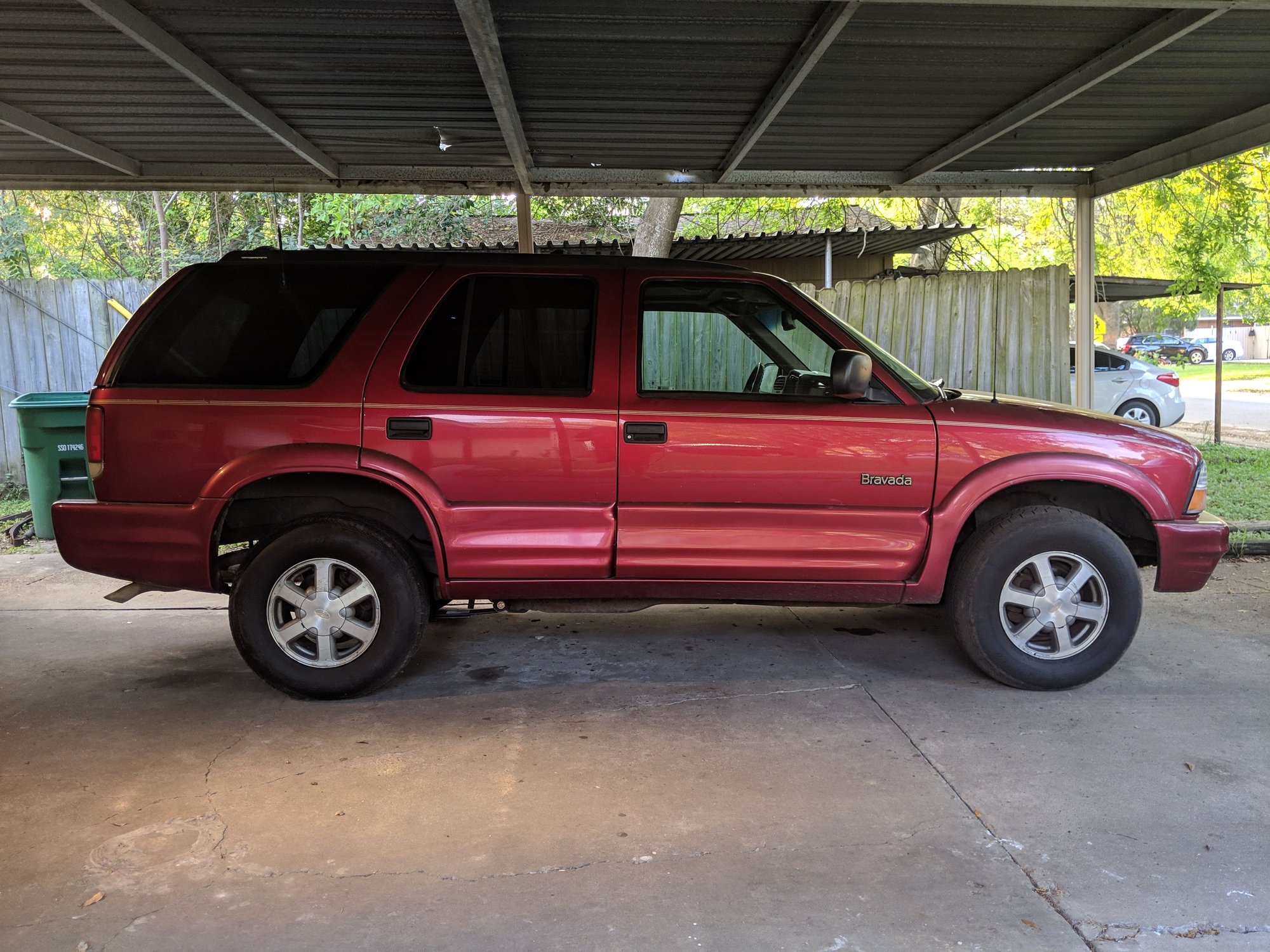

2000 Bravada, AWD auto, 177k mi.
I replaced my leaf spring shackles today, and in so doing, I removed the charcoal canister to better access the shackle bolts. When I was done, I reconnected everything exactly as it had been, but now the engine will not start, as though it is getting no fuel. I'm utterly baffled about what could be wrong here, someone please give me a clue.
