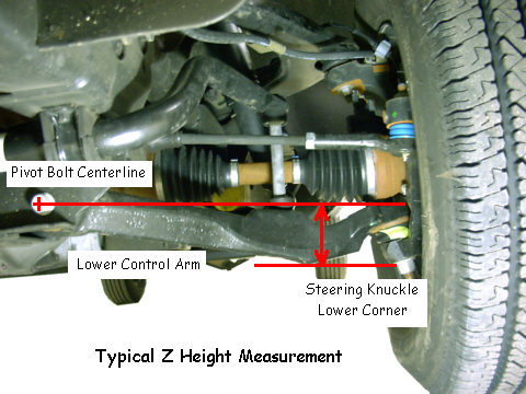

ok quick question how do you adjust the ride hight? im new to this side of things lol I just make things go fast haha

Vehicle must be on a level surface. Measure from the center of the lower control arm pivot bolt straight down to the ground. Then measure from the lowest inboard point of the steering knuckle to the ground. Subtract the knuckle measurement from the pivot bolt measurement, the result is ride height. Adjust by turning the torsion bar adjusters, (left & right) at the rear torsion bar mounts.
Bounce the front end, (like checking shocks) before and after each adjustment for an accurate reading.
1996 & newer:
4WD (except ZR2) = 4.6” to 5.0” (4.8” is preferred)
4WD ZR2 = 4.6” to 5.2” (4.9” is preferred)
