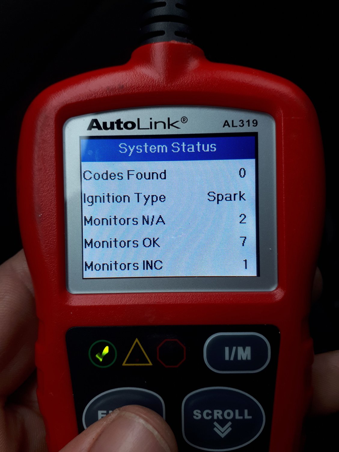

Old Dec 16, 2018 | 11:12 AM
Other pics of the reader
now these were all taken while engine light has been off... it's been off for a while now. It comes and goes with an evap code. I cant find anything, replaced the carbon box and sensor. Got a new gas cap. Checked the oring on the tank. I'm at a lost. My gas mileage is crap again. When I replaced the o2 sensor and cat, my mileage based back up to 425km/tank. City driving. Now its back down to 350-385km/tank.
