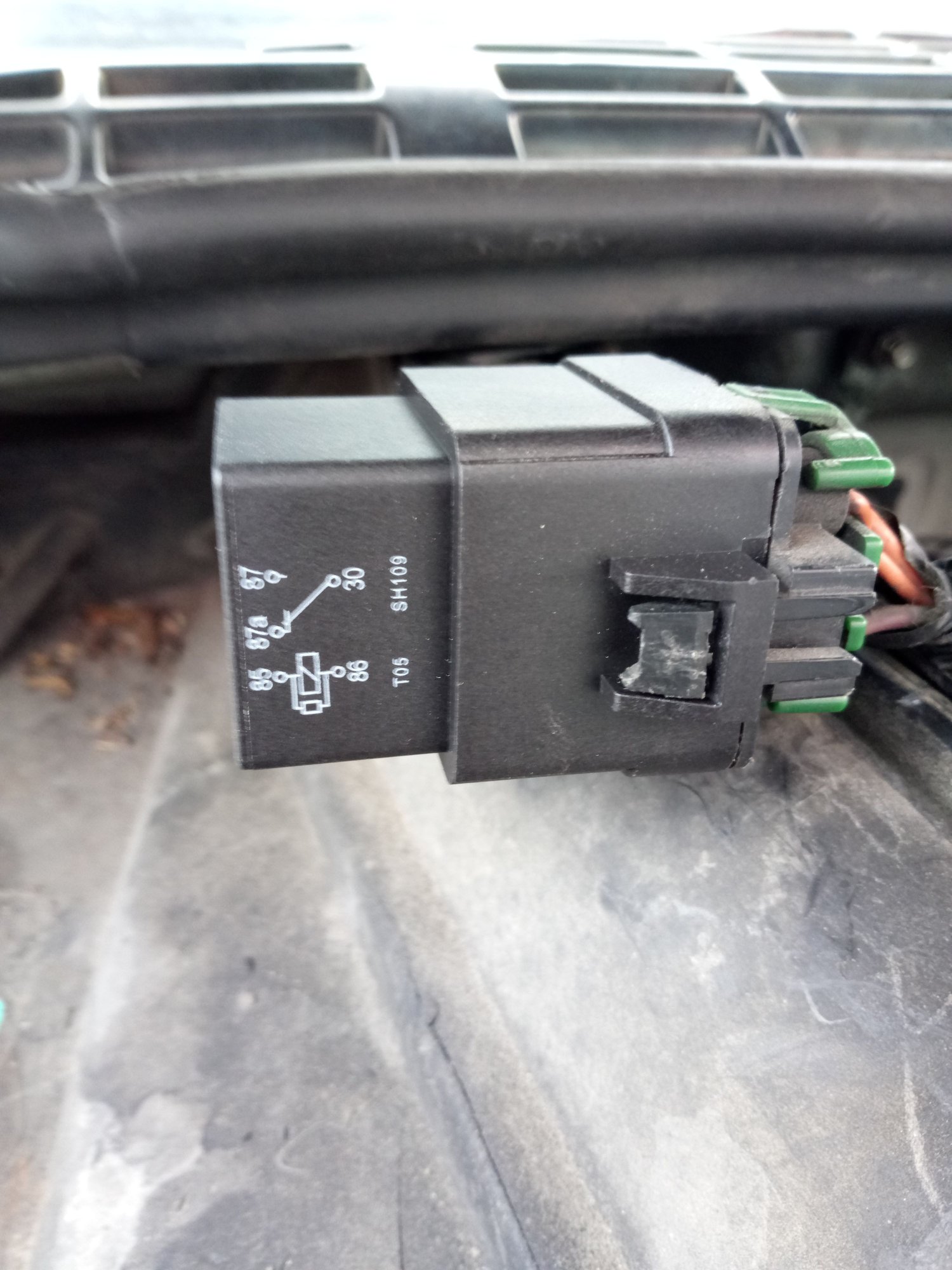

New relay.

How do I know which pin is upstream?

Pull the fuse and test both sockets for power. If you have power then while the fuse is out test the other pin to pin 87 of the relay for resistance/continuity.

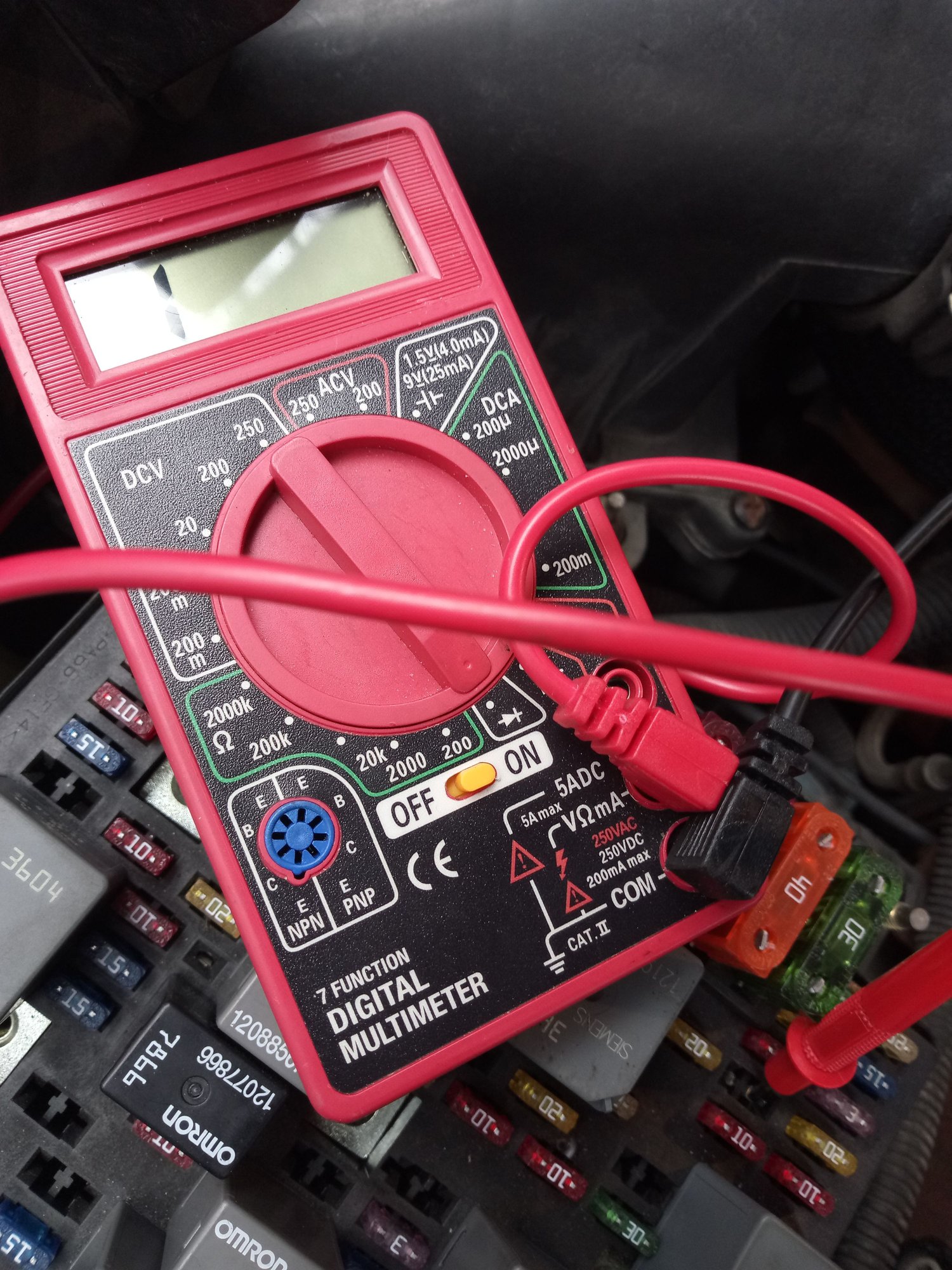

This side reads 13.7 other, 0.

Nothing?

Test from the fuse pin that did not have power to pin 87 on the relay with the meter on 200 ohms and see what you get
George
Did I do it wrong?

40.5. what does this mean?

I cant tell if your in the hot side or the downstream fuse pin so I am verifying the pin that had no power and I would like to have you change the meter to 200 ohms instead of the diode/continuity setting as shown.
