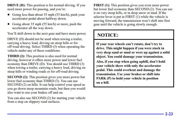

Pointing out the obvious: the owner's manual says to just put automatics in 3rd when towing a trailer, which accomplishes about the same thing.
The same manual also mentions the Tow/Haul mode, but I don't think I've ever seen a Blazer equipped with it. It's quite possible that it's just an artifact of sharing the same cluster across lots of similar truck/SUV models for lots of years.
Yeah, I committed the ultimate sin of not reading the manual. LOL
Hey don't feel too bad. I only vaguely remembered something being there about towing and couldn't remember what it was, had to look it up.
It's also super handy having a .pdf of the manual handy. If anyone doesn't have one they can be downloaded from GM here.
That link is where I got my owners manual!
Also, after I had the transmission rebuilt the owner of the shop that did the work made me promise to never use over-drive again while towing. LOL
