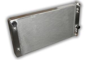

Oh, I forgot to report what I ended up doing.
It was a tough choice but I ended up going with the radiator from Engineered Cooling Products (https://www.speedcooling.com/Chevy-S...ing-Tubes.html) I chose it because it was purportedly made in the US and had a very large surface area to the tubes in the core. (I tried to quantify this in my spreadsheet in the post # 31.)
Engineered Cooling Products radiator
The downside to this radiator is that it did not come with a provision for the oil cooler lines.

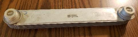

I looked into installing an external air-cooled oil cooler but the price for parts alone quickly got above $300 if not $350 for a quality installation. So as a substitute I discovered aluminum versions of the internal (to the radiator) oil coolers. (https://www.thermprocesses.com/produ...oducts_id=2595)
Aluminum in-tank oil cooler
New (top) and OEM (bottom) in-tank oil coolers
The advantage of these in-tank oil coolers is that they would accept the OEM fittings and no new hoses would be needed. However it means that the radiator I purchased would have to be modified. I am having a local heavy-duty machine shop cut out the rear facing panel on the left side and TIG weld the cooler to a new cover and then the cover over the hole. (The oil cooler being aluminum will allow for the TIG welding and have a very high thermal conductivity.)

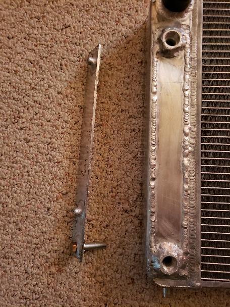

Bit of an update on the new radiator.
I had the aluminum OEM-style in-tank oil cooler welded into the tank. I got it back today. The cost was $150. If any of you are good at TIG welding or brazing you could save money if you do it yourself. I borrowed a radiator pressure tester to check the welds and it was all OK.
Next steps are to install the new fittings for the transmission and oil cooler lines (a quick check showed they fit) and then install it. I expect some customizing of the mounting might be necessary.
(EDIT: I forgot to add that I purchased a radiator cap with a zinc sacrificial electrode to prevent electrolysis.)
Here some pictures.
Whole radiator with panel that was removed and replaced.
Close up of replacement and side view of removed panel.
