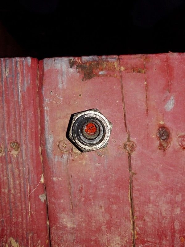

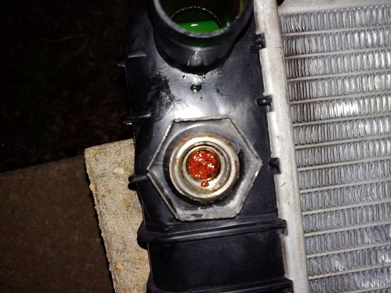

So I got the radiator out, and of course the new (lifetime warranty) radiator doesn't come with new trans and oil cooler fittings. So I pulled them off. The ATF line connectors and the bottom oil cooler connector were fine. Then I took the top one off.
Here is the connector
This inside the top of the radiator.
It is really packed in there too, it appears to be orange RTV. I have no idea where it came from.
Dang! Do you know the history of repairs on your engine? Could some RTV had been squeezed into the water jacket?

At first sight it looked like redwood chips...
Uh-oh, If it is RTV sealant somebody thought that more is better. But inside an engine you need "just the correct amount" of sealant spread on joints and gaskets. Seen stuff like that before. Engines stuck together with sealant which was in every passage.

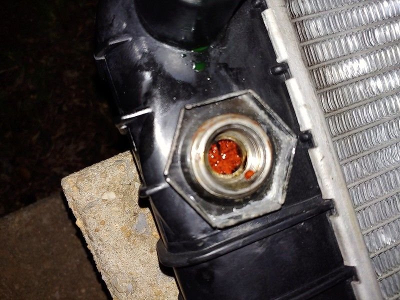

That is the oil passage that is packed with this stuff. If the radiator wasn't lifetime warranty I would tear it apart to see what's up. I did order and LIM Fel-Pro kit. Rockauto had them super cheap yesterday. Today they went back up to normal price. I have the radiator in my trunk and I was able to pull it out. it is just like shredded RTV.

Look at this junk I pulled out of the radiator.
