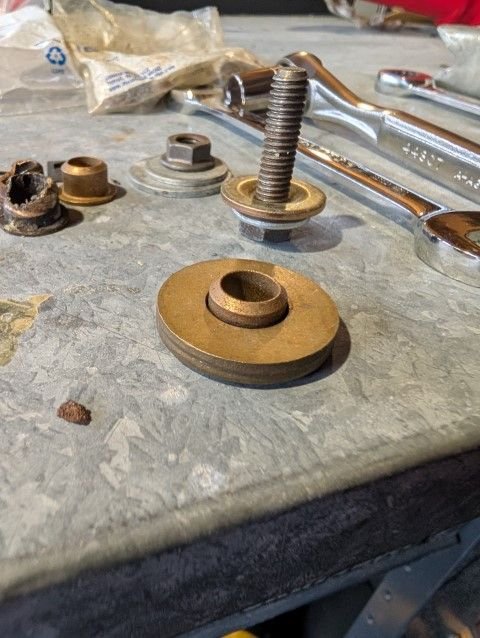

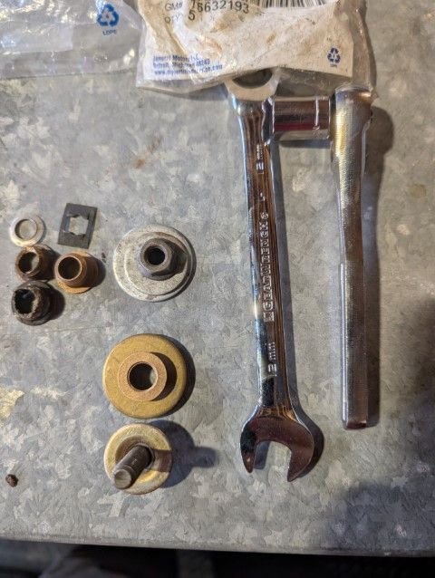

I recently had a annoying issue with my 2 door blazer driver side door making the loudest squeezing sound. No amount of lithium grease, dry silicone lubrication, 3in1 oil, bearing grease or praying made it go away longer than 2 days. After further inspection, I noticed the upper hinge bushing were beginning to crumble. The lower hinge pin was also creeping up. I got some OEM bushing and pins and got to replacing them. The job is straight forward with a couple of tools and a jack the job can be accomplished fairly quick. Start by using a spring tool to remove the indent spring. The biggest hassle is pounding out the upper pin. A large, long drift tool is key here. The door should be propped up with a jack before removing the pins. Replacing the bushing is best done with a homemade press. I read hammering this back would result in premature failure, making you redo the work once again. A bolt and couple of washer do the trick. Then just pop the pins back in, with the upper pin getting a retainer clip. Keep in mind the upper and lower bushings are not the same PN, however the pins are. Use the spring tool to reinstall the spring.
Crumbled Bushing
Crumbled Bushing
Lower Pin
Lower Pin
Spring Tool
Spring Tool
Drift Tools
Drift Tools
Old Hardware
Old Hardware
Press
Press
Washer
Washer
new upper retainer
new upper retainer
new upper pin
new upper pin
New lower pin
New lower pin

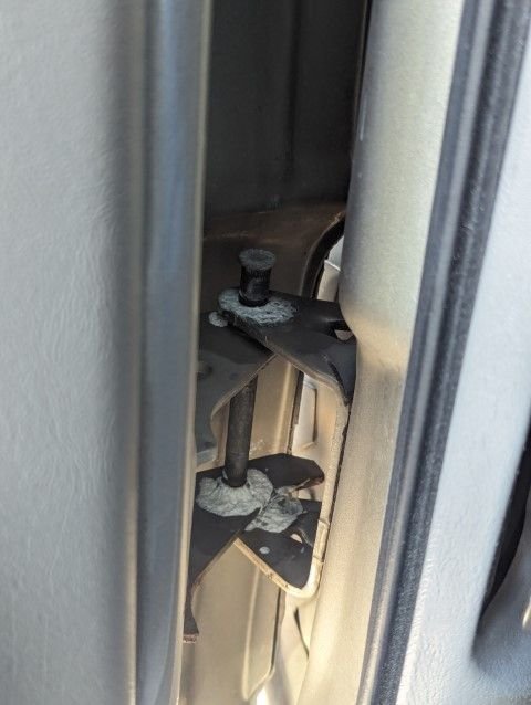

Here is my Issue after the install the door doesn't seem to want to close right. The door latching mech seems to struggle to engage the striker. It takes more force to close then before, and the sound is off. It almost sounds like it's hitting something. I used a flashlight to peak between the door and a pillar frame and latch. The striker appear to be center and not misaligned. I solved one problem but got another just at annoying problem as a result. What gives??

As for the door not closing correctly, is the door aligned to the body? Does the door want to move up or down as the latching mechanism engages with the striker? With the door slightly open does it look like it aligns with the body?

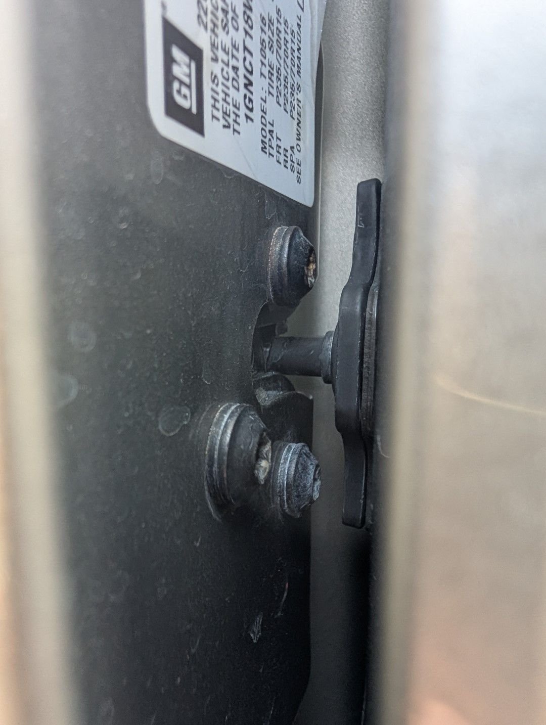

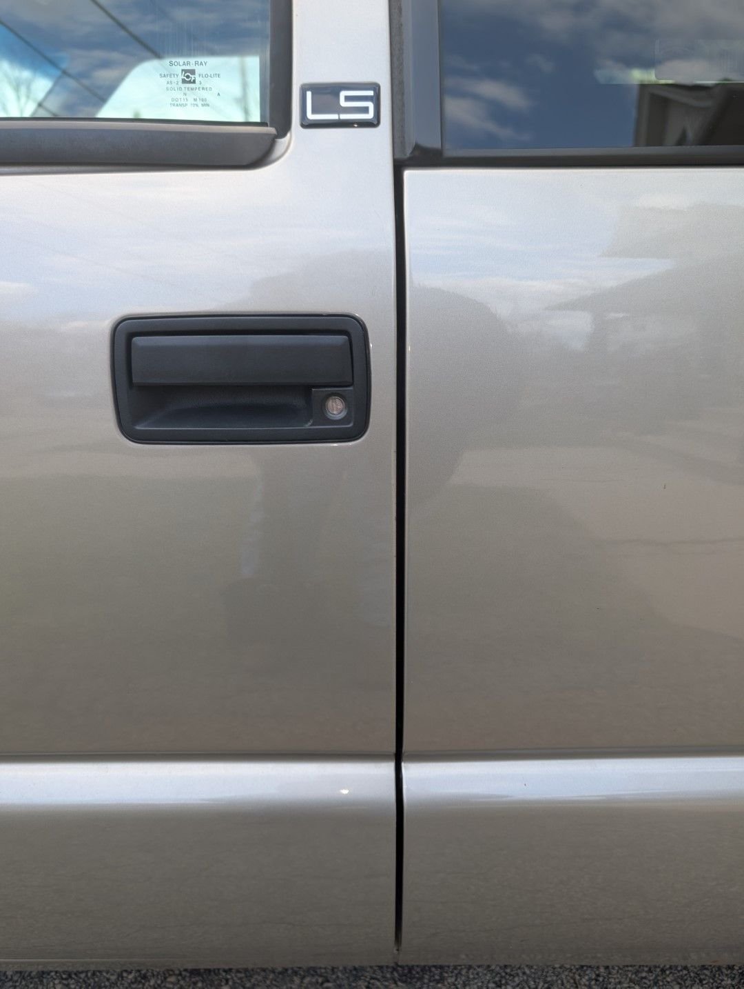

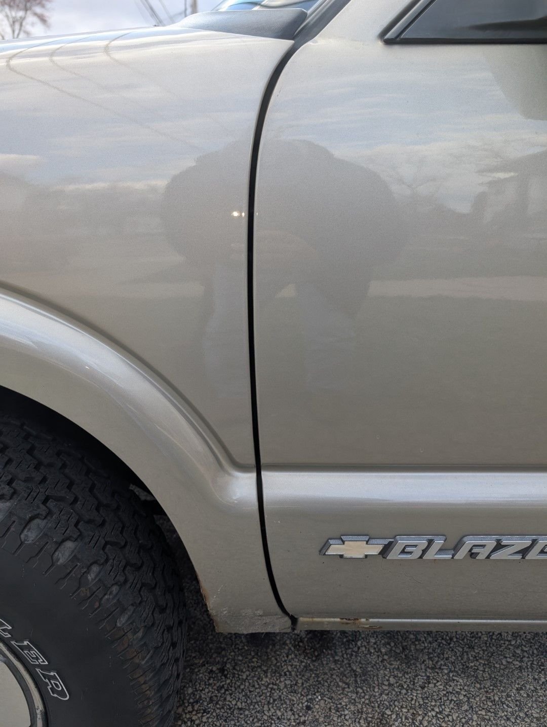

The Gaps look flawless left and right. It appears like the door is slightly too high, if anything. I put my weight on the door while closing it, and it seems to help the latching. I tried to adjust the striker, Warning, please read this before removing the striker screws. The striker has no adjustment. In fact, if you back out the screws completely, the backing plate will fall inside the body. This means you will need to remove the entire interior trim of the same side. That's a huge pain, believe me, I used a flashlight to peek in-between the door and frame and the striker seems to line up. I will try to take a photo. When the door shuts, there is a subtle thumbing sound. This sound was not there before, and the passenger door does not make the sound.

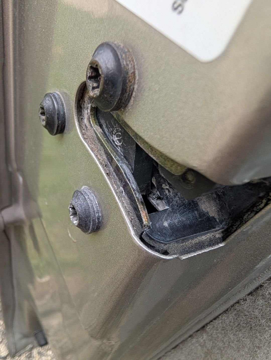

It looks like the door latch is hitting the bottom of the latch. Does anyone know if the latch is adjustable.
Left side door gap
Left side door gap
Right side door gap
Right side door gap

The latch does not have real adjustment. I used a T30 to loosen up the screws to the latch and managed to drop the latch only 1mm. This however, was enough to get rid of the annoying thumb sound. I did spot wear from the impact on the latch see image. I am not 100 satisfied with the door closing, needs to be dropped another 2mm to be perfect. I am hoping the bushings will wear-in and allow for a bit or natural sag on the door. This will take some time of course and for now this will have to do. Also does anyone have the torque spec on the latch screws?

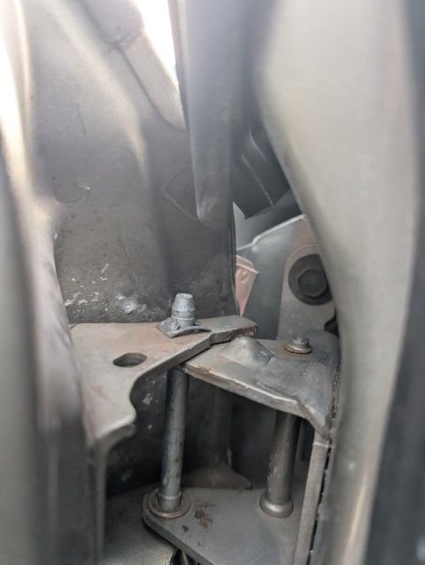

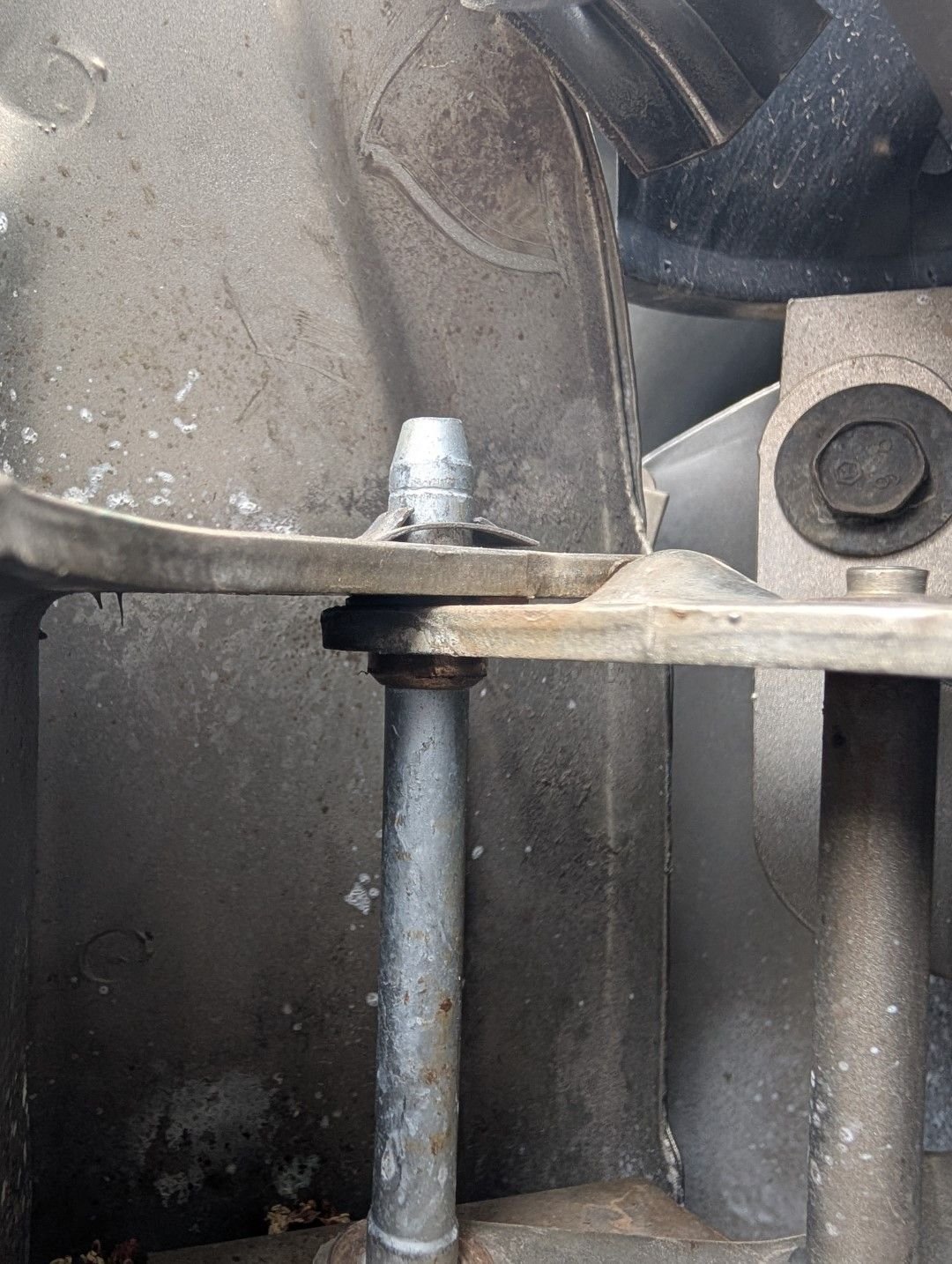

I wonder if your bushings are seated properly.

The bushing appears to be completed seated.

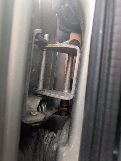

New Bushings & Pin
New Bushings & Pin
Close up
Close up

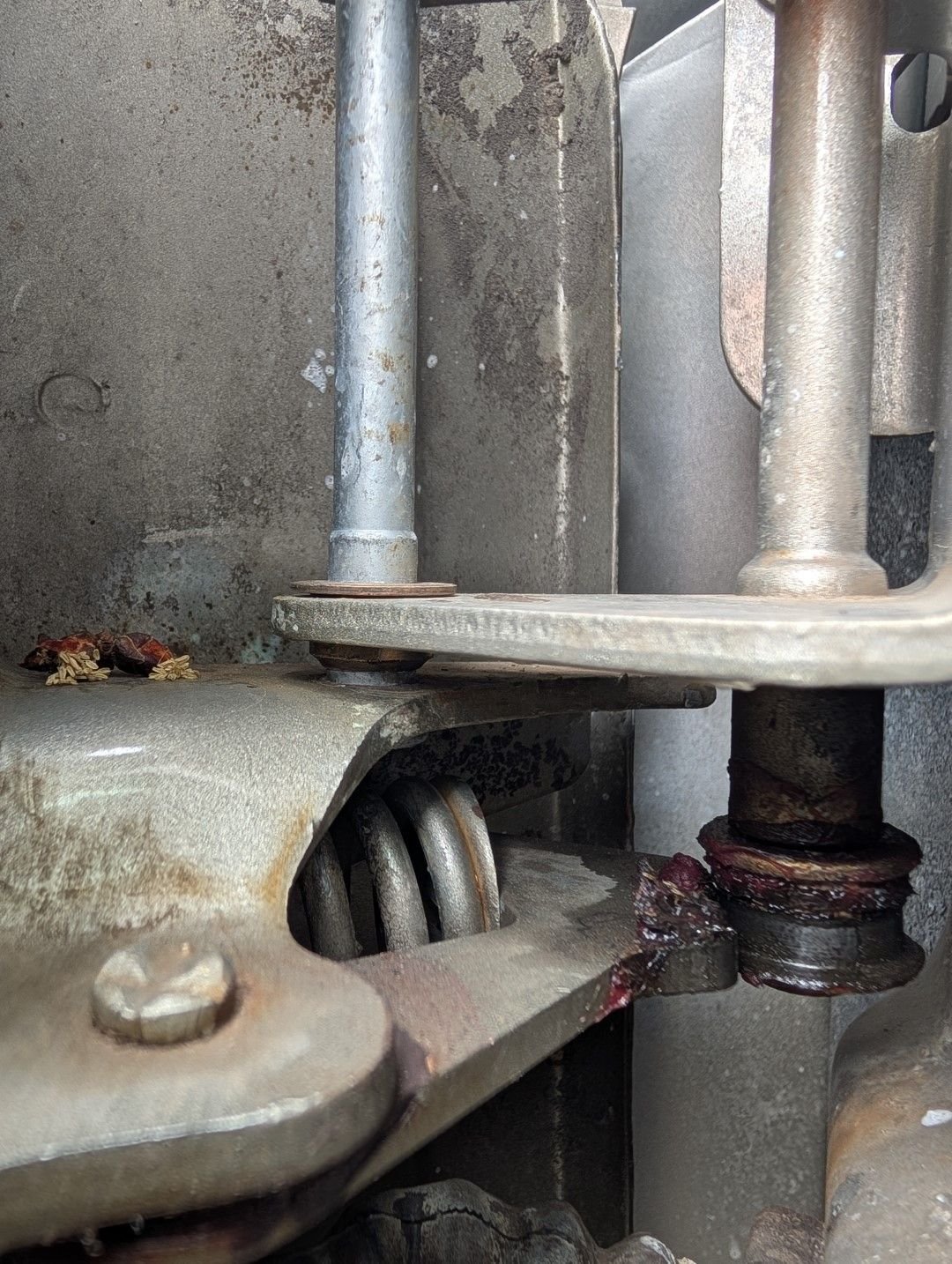

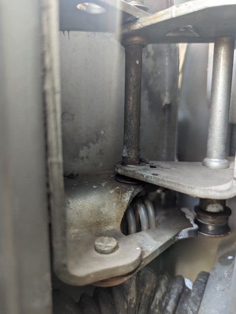

It almost looks to me like the lower bushing is installed upside down. If I understand correctly, the lip of the bushing is supposed to ride between the ears of the door and frame hinges. If so, do you suppose this could cause misalignment?
I am not an expert on this so maybe someone more knowledgeable than me could take a look and advise.
Old Apr 3, 2025 | 12:50 PM
mugenmundo's Avatar
Joined: Apr 2022
Posts: 84
mugenmundo is on a distinguished road

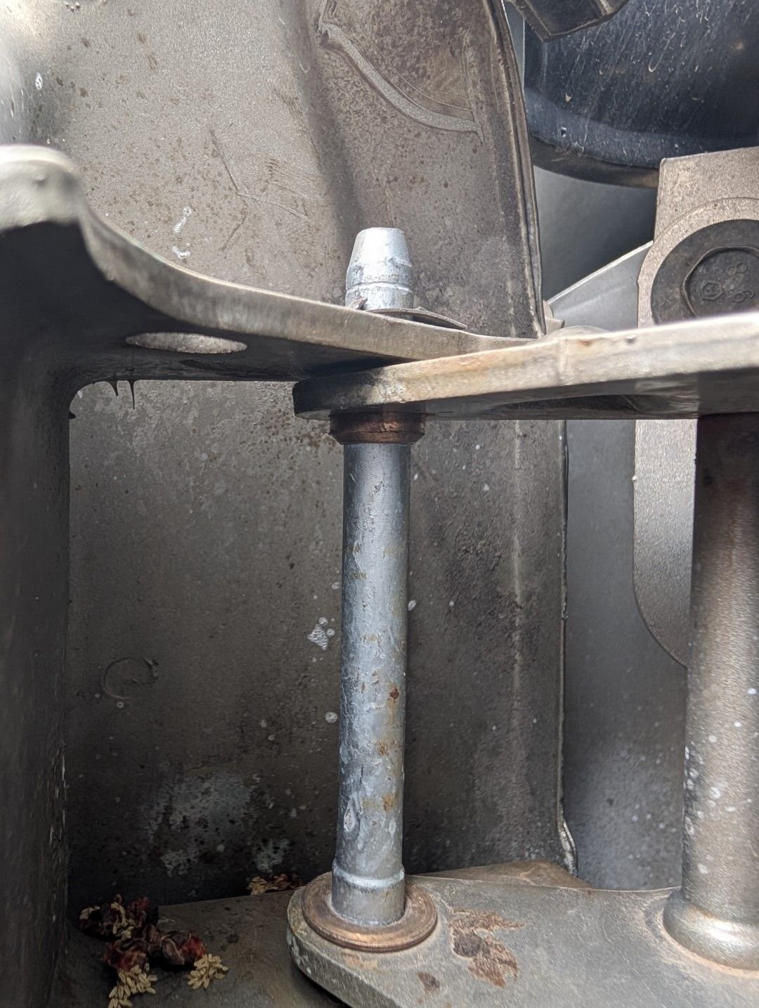

Correct, this is really import for the upper hinge ear as the weight of the door rides on the bushing washer. This acts like a bearing surface. The lower hinge ear does not make contact with the bottom of the hinge, only the pin. I don't believe this would affect the height of the door, as it's only there to hold the pin in center alignment with the upper bushing. Look at the photo I took of the right door that has the OEM bushing. It is as you described upside down, however notice there is a gap between the ear and body hinge.
Rusted Right side Bearing no spring
old right side door bushing gap
New busing upside down with gap
