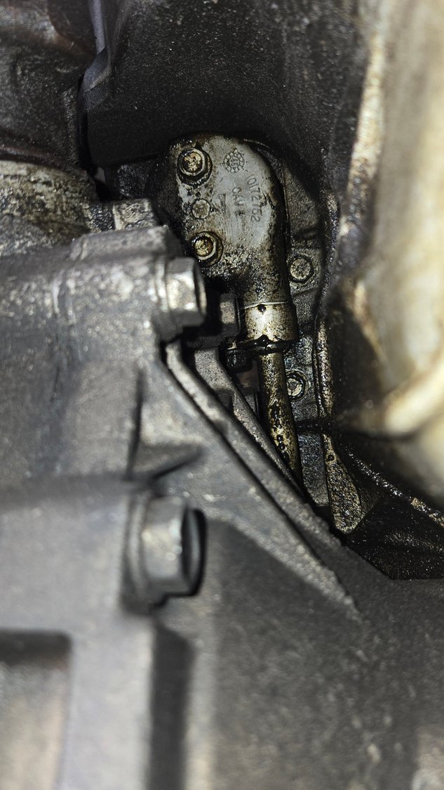

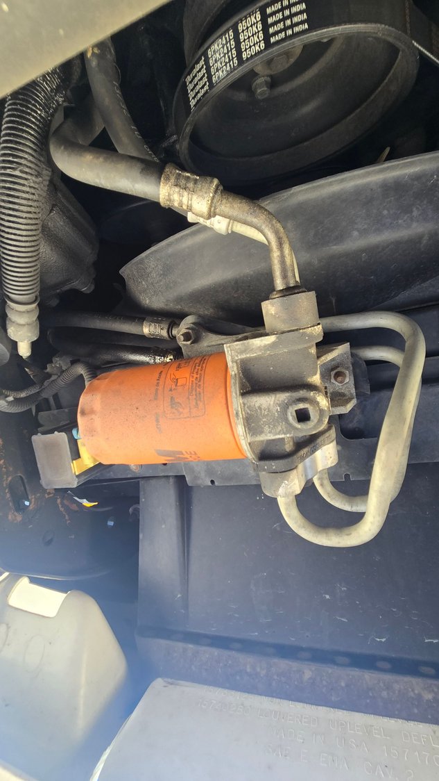

Oil cooler and filter
What im guessing is the cooling side, but wierdly has some oil on only one of the hoses?

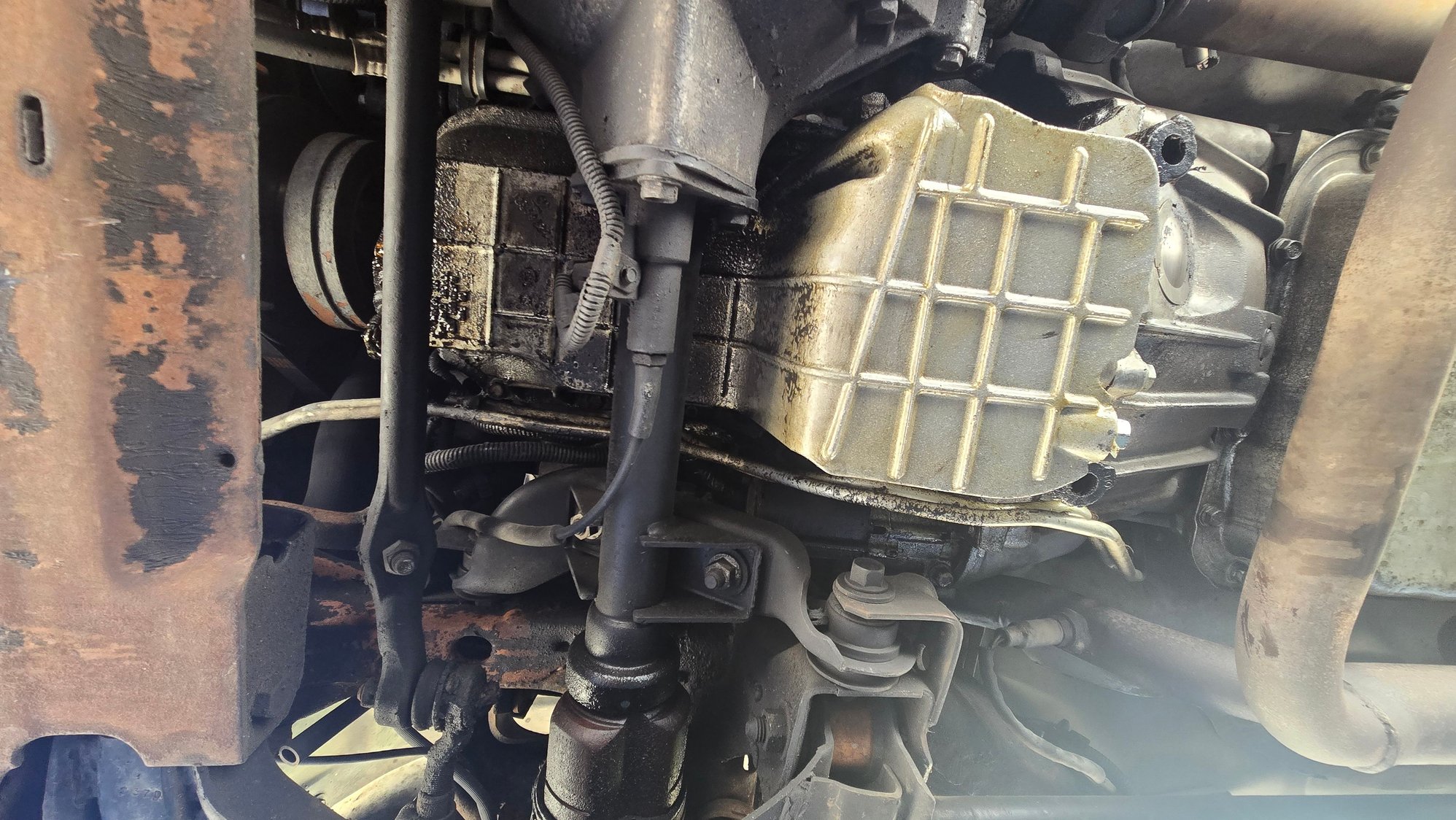

Overall underside behind subframe
Definitely seems like this could be the cause of the leak? Seems to be more wet than the rest although its kind of everywhere.

Yep! And to be thorough, replace the gasket and o-ring at the adapter at the block. I had the o-ring break on my 92 Blazer. But first I'd spray everything down with degreaser parts cleaner to help identify the location of the leak.
Something you have likely already learned is that space is limited and access can be limited to reach these parts. I think I used a 30 inch extension to get at the hose mounting bolt where the hoses attached to the block adapter.
