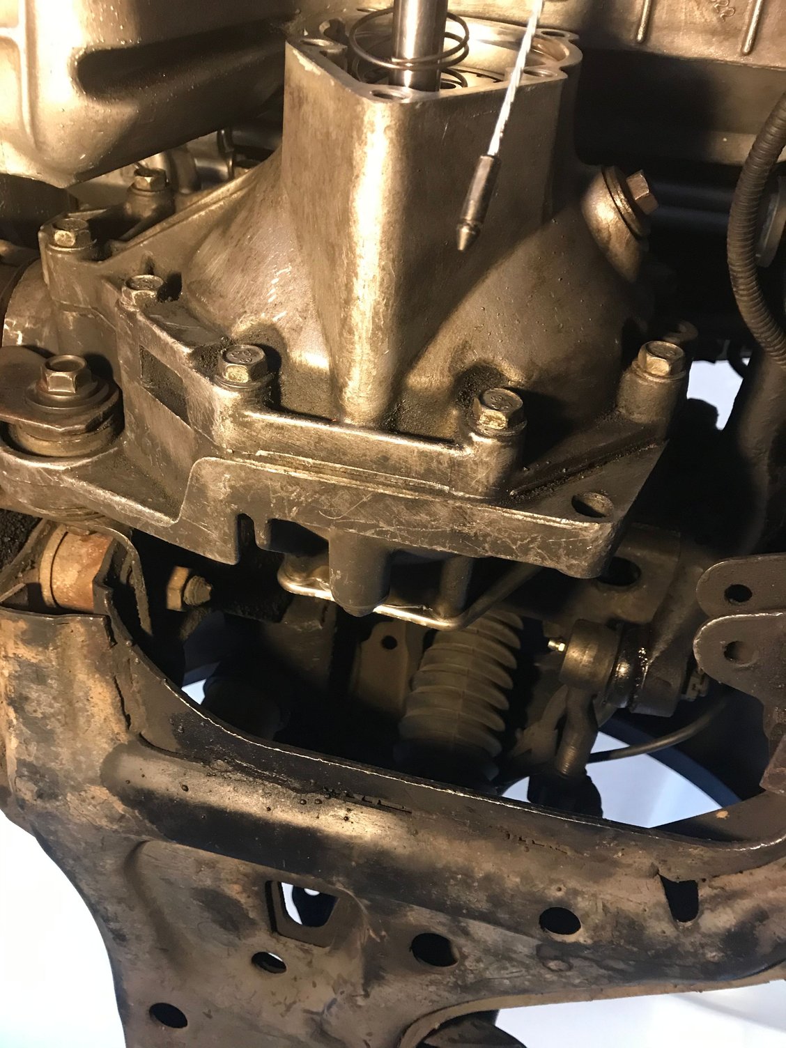

Today's task was to put the front diff in; well.....the score is, Gravity 5, Me 0.
I think I have it figured-out how the diff goes back in....just have not been able to do so.
The right side axle tube has to go up first, then the diff needs to be angled with the output down, then lifted-up so the forward end can be placed onto the crossmember, pushed forward a bit, then raise the output end so that the rear mounting ear is inline with the flanges, push diff forward, put bolt in, then raise the forward end so the forward ear goes up to it's mounting flanges, get the bolt in......then hopefully the right side tube mounting flange is aligned with the frame flanges...put those bolts in.
Sounds easy right?
Trying to keep the diff on my floor jack pad at these angles, pumping the jack with a leg, holding the diff in place........Like I said, Gravity 5, Me 0.

Score update: Gravity 8, Me 1.....I only need 1 to win.
I ended-up removing the right-side axle tube along with all the internals which lightened the diff plus stopped it from falling to the right side. Took me another three tries to get the right combination of angles but I got the forward end on the crossmember, then holding it in place with one hand, moved the jack out of the way, got under the diff, with both hands on it twisting and lifting got both ears into their mounting flanges. So again holding with one hand, QUICKLY grabbed the jack, got it under the diff, pumped the jack with one leg again (so glad that there was no video of this!!!!)....with jack supporting the diff, grabbed a mounting bolt, wiggling the diff got the rear one through, then the front one. Got the two nuts on, tightened them down.
Have to mention that getting the washer on that front bolt is a PITA....have to fish the washer into the frame channel by going through a gap under the left forward upper control arm bushing using a pick-up magnetic and a finger in the access hole. This is not a bad as the earlier 2nd Gen Blazers where the left upper control arm has to come off as there is no access hole in the frame (from what I have read anyways).
Bottom line.....diff is in.....just have to put the right side axle back on.
