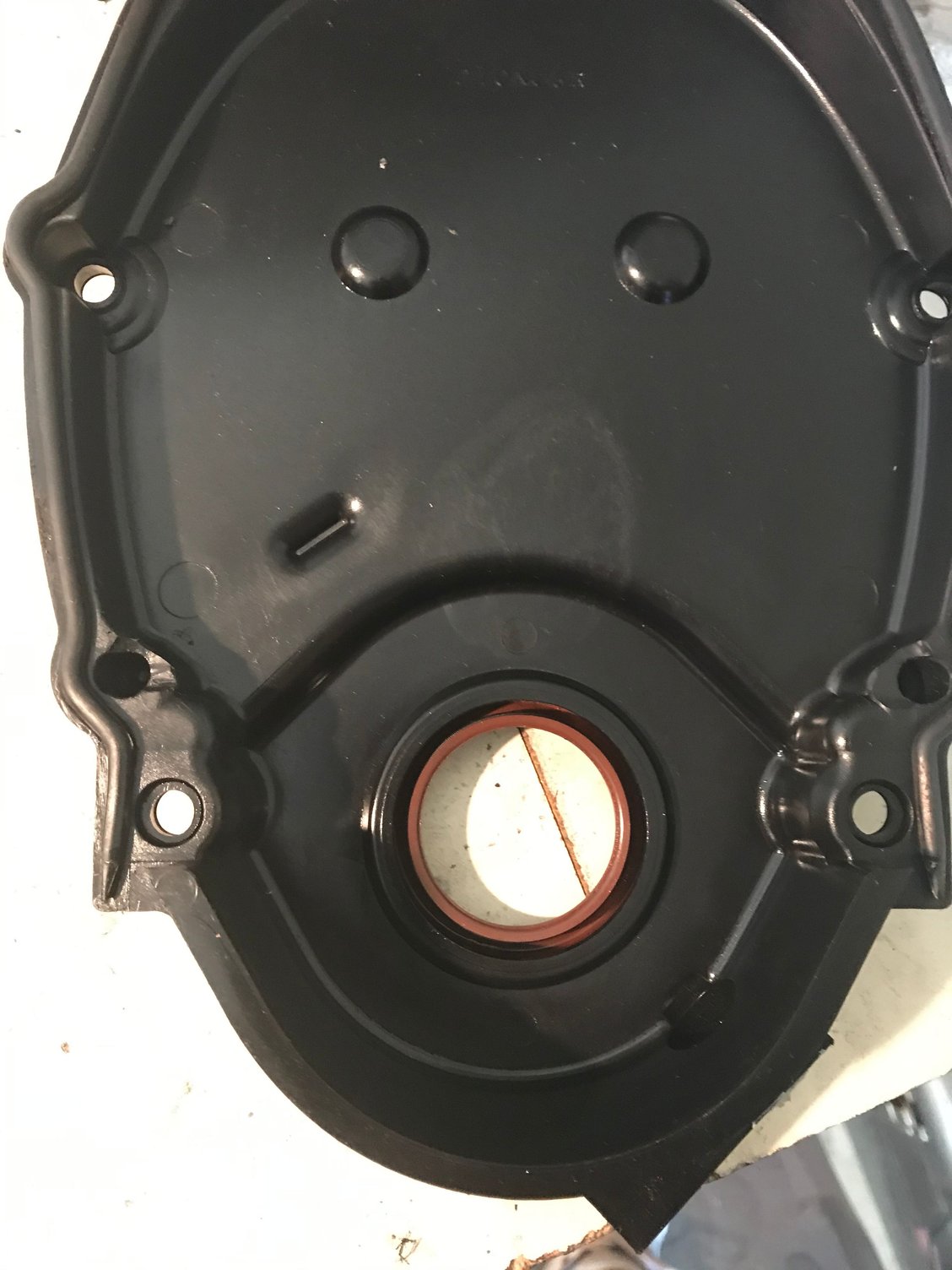

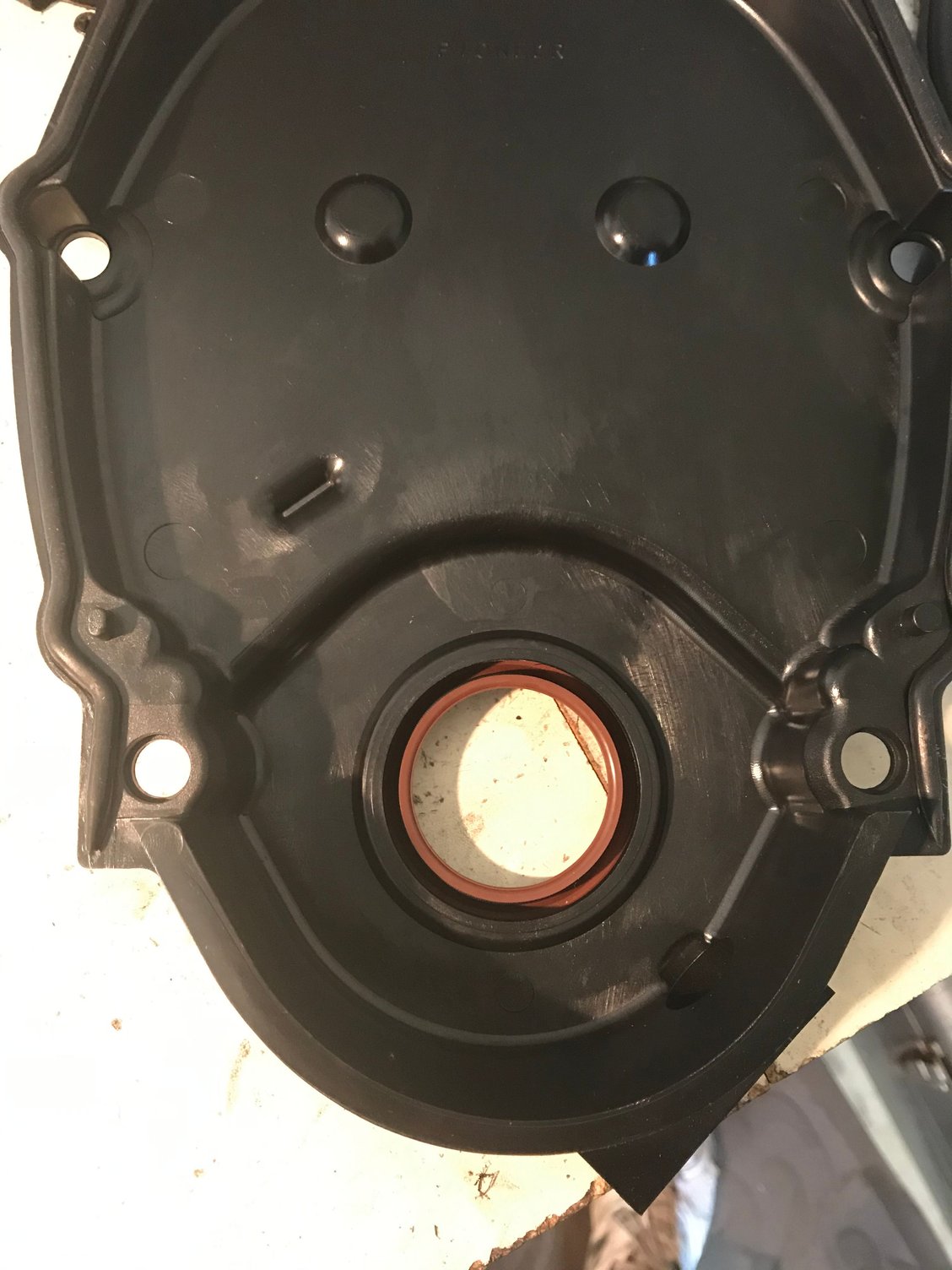

Thought I would share the timing cover modifications that I think are necessary in order to have the timing chain tensioner.
Picture 1: the new Pioneer timing cover. Note the two molded alignment pins above the two bolt holes, on each side of the crank seal.
Picture 2: modified Pioneer timing cover. Note the two areas where the alignment pins used to be. Drilled and clearance'ed for the timing chain tension bracket.

Along with the timing chain tensioner are two pins that are driven into the block to hold the tensioner bracket. Problem is, these pins now protrude 5/8" above the surface. You could drill the timing cover clearance holes that deep, but this depth does not allow much error as the timing cover is only slightly thicker than 5/8". So I used a Dremel tool and shorted the two pins.
The cover now fits flat against the block. I am still going to add a thin layer of RTV along the gasket for a better seal.
