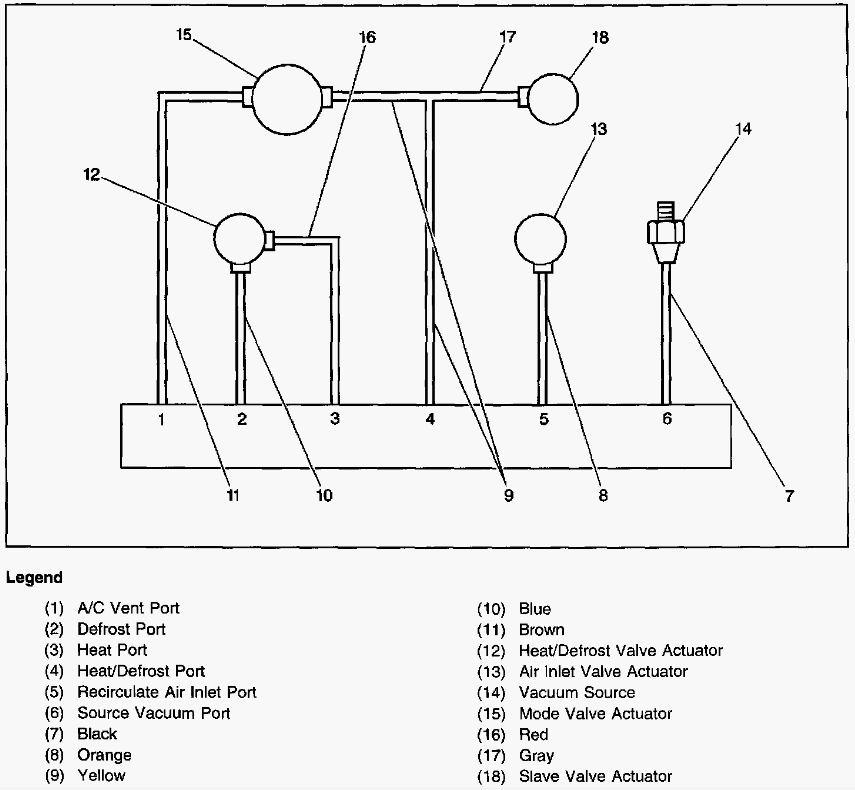

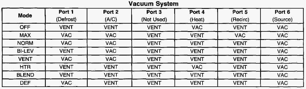

For both a 97 and a 98, the air temp door is an electronic actuator.
Here are the vacuum logic and a diagram of the system for a 98:
The system schematics are the same between the 98 and the 97:
And the problems being described by the OP seem to be a bit different than yours Anthony as your truck takes ~10 minutes to have a diminished HVAC airflow output while the OPs takes 5-10 seconds.
