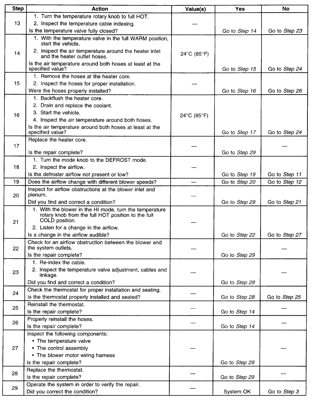

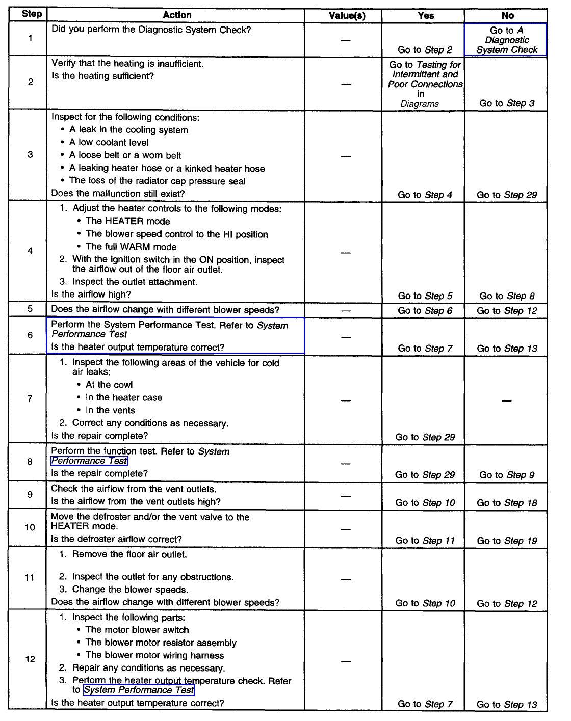

The temperature blend door is electric. It is possible that this door is either stuck between modes or is not closing all of the way.
Here is the diagnostic procedure for "heating insufficient":

The charts above will lead you to the proper conclusion, but by all means, get the appropriate tech manual.
I could throw some idea out there, but unless you verify it with the proper diagnostic steps, it really is just throwing something out there.
