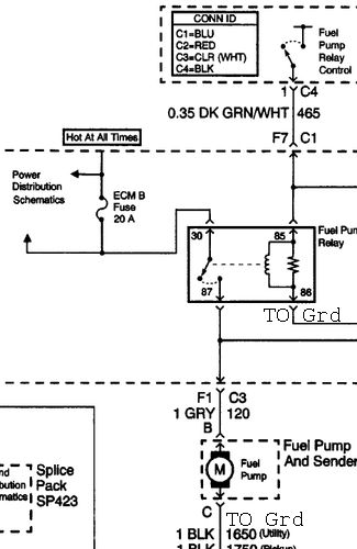

First thing I did was verify the problem was the fuel pump. I couldn't hear it at key on but I couldn't remember hearing it anyway so the first thing after dropping the wife off at work was buy a Fuel Pressure gauge: $52 at O'Reilly's.
No reading at key on.
Checked Fuse ECM B 20A. 12v to grd both sides = good
Swapped FP relay with adjacent same p/n .. no result.
pulled relay out a little for access to pins
EDIT: Actually that wasnt necessary on my 99. Locate the FP relay. From over the fender, just to the left and next to the relay is a single set of contacts. That fuel pump test connector is the same as relay '87'.
With key off you can check resistance of the pump to ground. Should be 10 ohms or less. Turn key on - should be 12v for two seconds.
Click image to Enlarge
Jumped pin 30 to pin 85 BE CAREFUL.. make sketch minding that pins will be mirrored when base down. Might want to NOT do this.
- relay clicked, no fuel pressure.
Ohmmed out pin 87 to GRD. No continuity.. meaning FP not getting power or grd, open circuit somewhere.

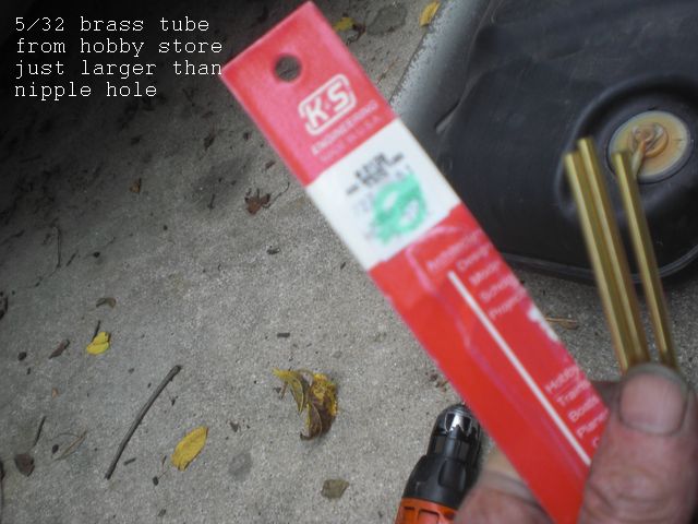

The answer would be to fix it with hobby brass tubing!

To the Hobby Lobby store 5/32" brass tube, package of three for $3.99.
- I'd checked the vent nipple ID with drill bits. 9/64 passed, 5/32 wouldnt, so 5/32" is what I wanted.

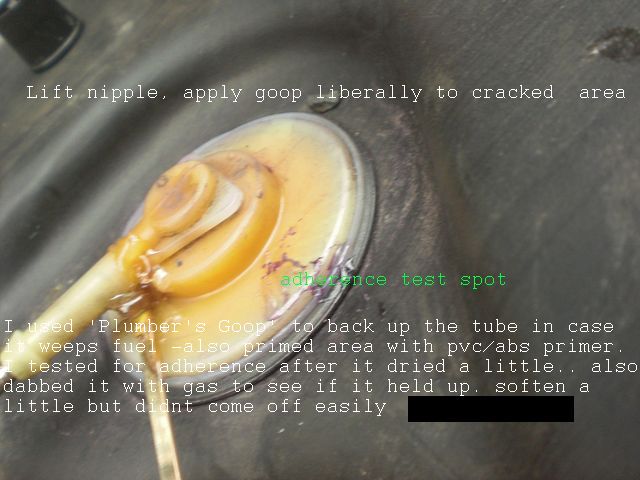

The first thing to do was test the stuff I wanted to use for crack sealer. I've never had much luck with epoxies on plastics, especially slick plastics that would flex, as this nipple surely would. The idea was to smear a thin layer of Plumber's Goop (TM) and let it dry while I was tending to removing the pump.
I cleaned an area on the vent valve and primed it with the standard purple plumbing primer. It's rated for PVC and ABS but I'd used it to remount mirrors with standard gel superglue and it seemed to work fine.

I scratched the test spot and saw the Goop adhered pretty well. I put a few drops of gasoline on it and found it held up well, just got a little slick on the surface.

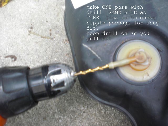

Then I marked the 5/32 bit for penetration and made one pass through the nipple, keeping the drill running as I withdrew it. Only took out a thin shaving.
Click images to enlarge
I drilled the length of the passage but realized later it would have been better to stop just a little past the crack so the tubing would have sealed even better.

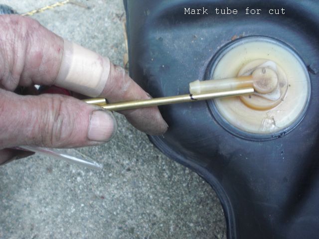

Then I primed and, while lifting nipple a little, sealed the area just around the crack using the Plumber's Goop.

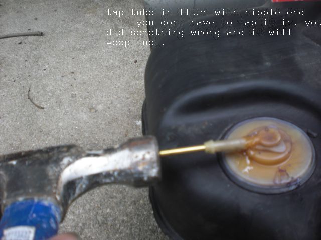

I marked the 5/32 tubing for the full length of the nipple passage, cut and deburred then tapped it in till it was even with the end.
