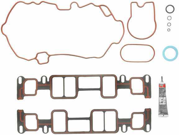

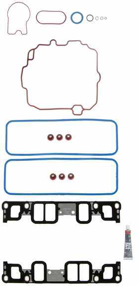

As Chuck has stated, get the MS98002T kit. This kit has the metal framed intake manifold gaskets that are a MUCH more robust design. MS95817 is still the old style plastic framed gaskets. I ran through this for someone else back in 2008.
Originally Posted by swartlkk
Um... Why two different PNs for the same engine???
*EDIT* - Figured it out. These aren't different PNs for this gasket 2wd vs 4wd, but rather different gaskets.
Fel-pro MS95817 - Plastic cage with overmolded o-ring for the lower intake manifold and includes all of the other seals/gaskets used on the intake.
Fel-pro MS98002T - as you can see, it includes everything that the previous set does plus the valve cover gaskets and seems to have a different overmolded o-ring material. Not sure, but looks to have a metal cage as well.
**Just did some more reading up on these and they sure do have a metal cage. These would be what I would recommend getting!! All of the short comings of the factory gasket have been addressed in this gasket. You should have no other problems after correctly repaired with these gaskets!
I installed the MS95817 set on my Bravada when I did this repair. I never knew of the option for a metal cage... Would have used the MS98002T if I had known about it back then! LOL
