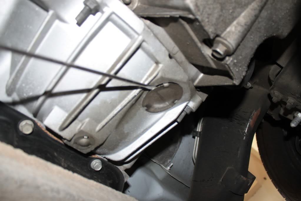

How many miles are on the truck? I've been through my fair share of these, and all but the most recent had leaky rear main seals that would soak the oil pan and bell housing. Pull the inspection cover on the bottom of the bell housing
If you see oil dripping out, or if it is soaked inside the bell housing, chances are your rear main is leaking. Not a job you want to undertake yourself, unless you are confident in pulling the tranny for a $20 seal.

I just hit 159k. Ill have to give it a try this afternoon or late evening hopefully when it cools down a little. The visuals do help thank you. I alsp notice the leaking doesn't usually leave spots on the road unless parked on an incline or decline

not one drop of oil after looking and feeling around after taking off the inspection cover. thats a good thing i take it?
