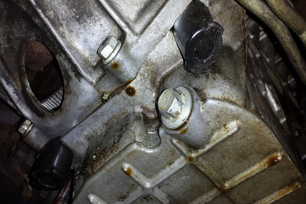

this is probably the best i could get. any ideas?
Attached Thumbnails just got my intake gaskets done, still leaking oil-rsz_2rsz_oil_leak_1.jpg

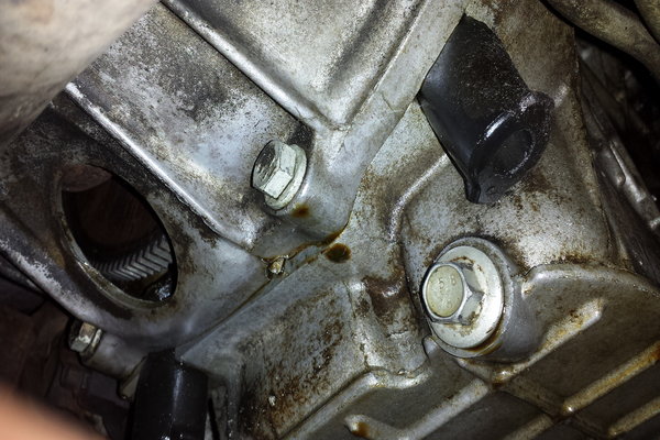

and this one too
Attached Thumbnails just got my intake gaskets done, still leaking oil-rsz_oil_leak_2.jpg

Honestly, it looks like it could be a pan gasket starting to bad. That's way cleaner than what I am used to, and looks like a very recent thing. I don't see much oil/dirt caked on the aluminum. The seal on the drain plug is definitely no good. A new drain plug is less than $10 just about anywhere, and be sure not to over-tighten the drain. It is an incredibly common mistake, and can compress the seal too much. That and countless hot/cold cycles on a steel plug in an aluminum pan is going to make your life hell next oil change. Is the radiator leaking at all? What is your oil level at and did you check around where the dipstick tube enters the block? It will be on the passenger's side, right above where the oil pan meets the block.
