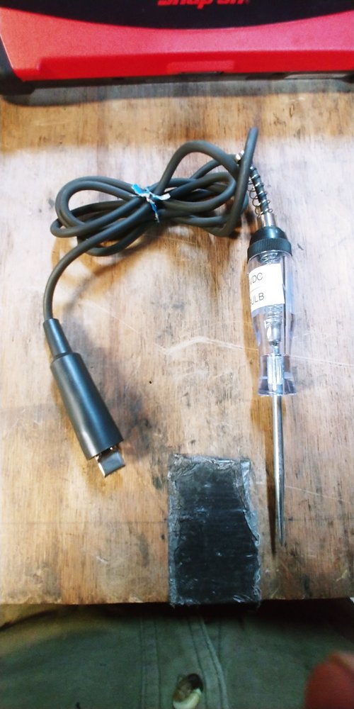

Kenneth, just wanted to point out when I say a test lamp, you just want a basic incandescent lamp like pictured. You don't need to get all fancy with it. For now stay away from "powered" lamps or LED lamps.

Ok rockp2 will do. And thanks for your time and help.

I also just placed an order with Amazon for the incandescent test lamp, it'll be here Monday.
