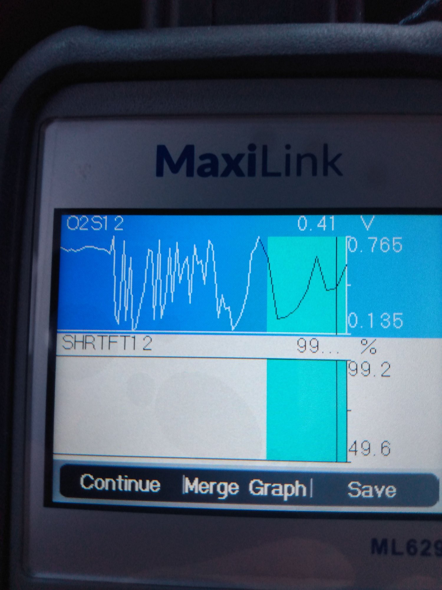

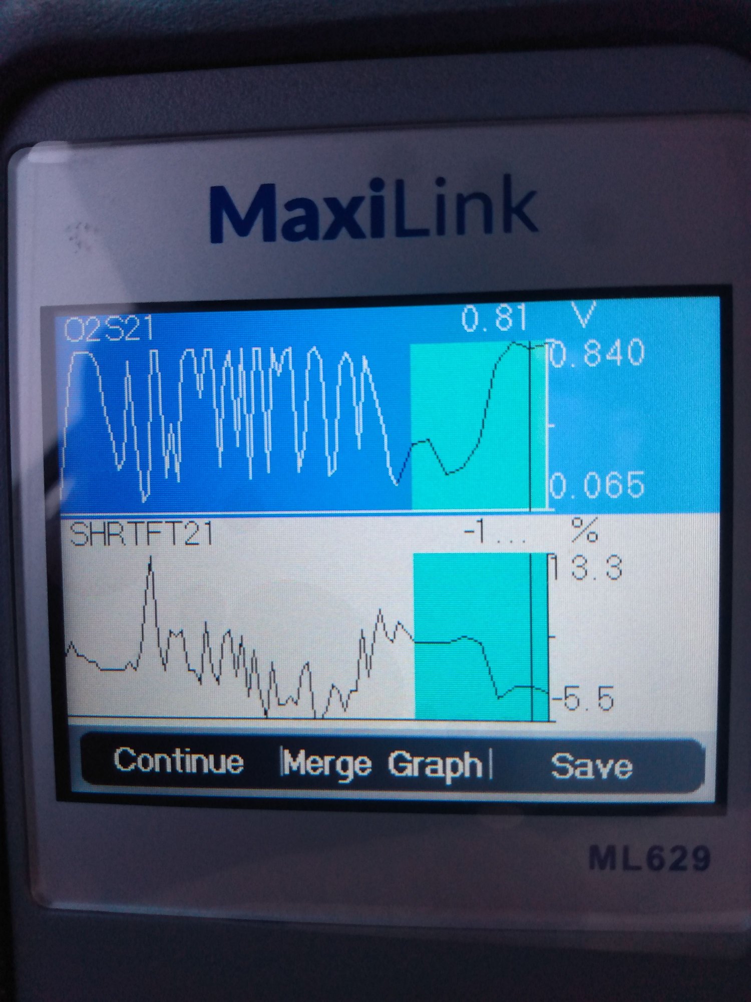

Ok, this is what I have today,
This is at 2500 rpm
This is at idle

  1. Which Autel scanner is this so I can go find a manual and follow along, I am unfamiliar with these models.
  2. Do you know offhand what the seafoam green area denotes on the graphs?
  3. It looks like one of the O2 sensors was repeated. We need bank 1 sensor 1, bank 2 senor 1 and bank 1 senor 2 (or 3)
  4. Is this data at 2 different rpms? you should include rpm plus all the rest of the sensor values like MAP, MAF, etc. Assuming that 2% load is idle and 9% load is 2500 rpm, your fuel trims get somewhat better at higher rpms which indicates the possibility of unmetered air although the change is not dramatic enough to explain everything unless your vacuum leak is massive like the brake booster. Check the air horn after the MAF and check for vacuum leaks
  5. Have you done the fuel pressure/leakdown test in the sticky yet? We are going to have to look for any fuel delivery problems and starting with the pump and pressure is the easiest start. The injectors get more complicated.
