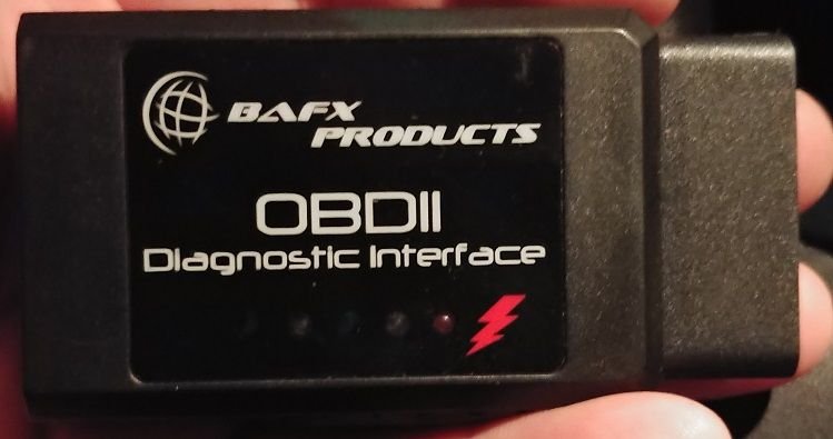

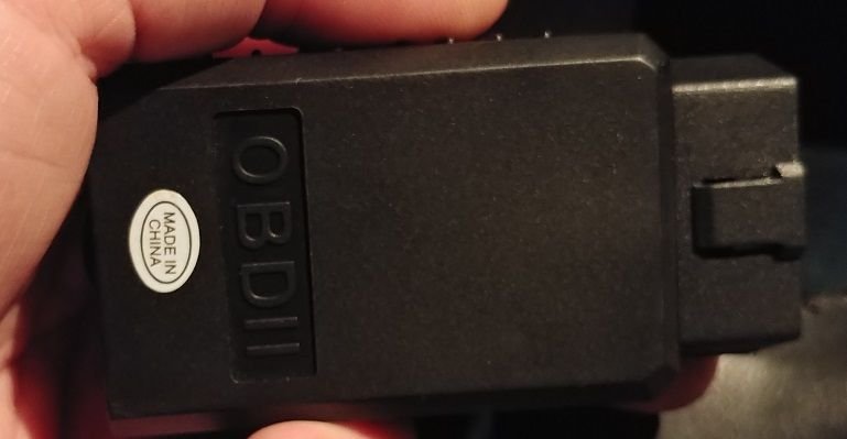

I see absolutely nothing wrong with how you operated Car Gauge Pro. I assume that it will monitor generic Powertrain PIDs like O2 sensor voltage and GM enhanced PIDs like cam sensor retard???? Maybe your OBD2 adapter is the issue? This is the infamous bidirectional control that cheap scanners are not supposed to be able to do. Didn't you say something about having to reconnect bluetooth a couple of times. I think yours goes straight to "10" because you probably don't have any other Bluetooth devices for your phone, and I have Bluetooth receivers in car and home for music and phone - so these pop up and I have to choose OBD2.
My adapter is the first generation BAFX Bluetooth OBD2 adapter from Amazon. I see that what they offer now is a different design case, but I know that people have bought them and they worked fine with Car Gauge Pro (although no one has checked things like this AIR Pump on/off activation with the new design). You could buy one of these and if it doesn't do anything more for you, then return it for a refund - Amazon is really good about that. That's the only thing that I have for you at this point.....

Is yours the BAFX one? In Torque, when connected to vehicle select Adapter Status/Adapter Manufacturer and Adapter Status/Adapter Version and post what it says. Also select Adapter Status/Adapter PID read speed and post what it says. I'll do the same, but have to wait until I get home from work.
You may want to be careful about reading too many PIDs at once. If your adapter only does 3 scans/sec - you spread those 3 scans over however many PIDs you are reading. I benchmarked mine once and my BAFX was 20 scans/sec. I had another adapter from Amazon and it was three scans/sec - horribly slow. The OBDLINKMX for $80 was 30 scans/sec and I sent it back (no real advantage on my Blazer for a lot more money).
Well I missed the part about the read speeds because i was in the truck reading on my phone but the Manufacturer"OBDII to RS232 Interpreter" and that section didn't seem to let me click it for more information. The Version reads as "ELM327 v1.5". There is however and error right above these as you can see that I didn't really pay attention too until now looking at them on my computer. I will have to go back down and check that out, maybe it is the adapter, maybe its a knockoff.
