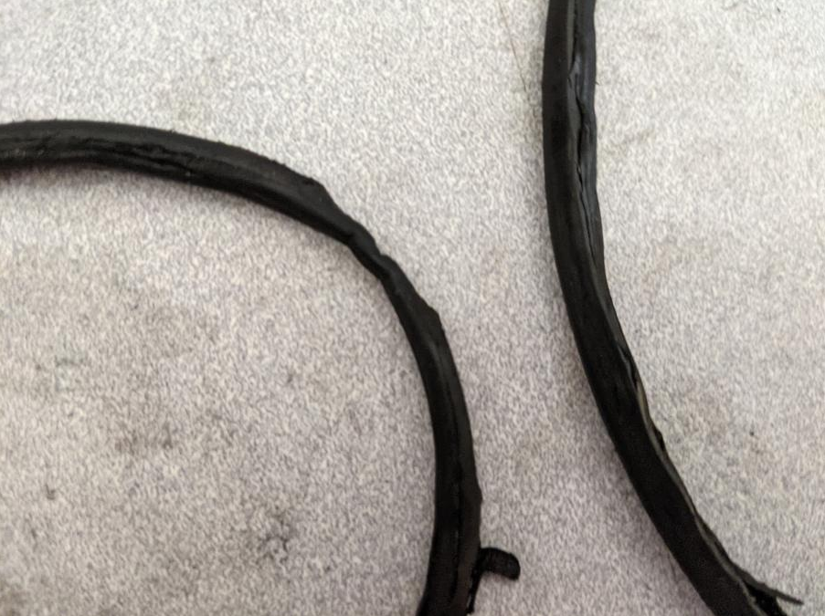

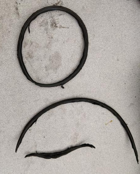

This past weekend, I was doing some brake inspection trying to chase down another noise problem, and I noticed some play in the front wheel hub. I took them off and the rubber o-rings that came with these brand new Detroit Axle hubs had disintegrated. (Don't recommend Detroit Axle at all!). I went around from auto parts store to store looking fro o-ring replacements, and the guys at the counter all said that they're not sold separately. In fact some hubs don't come with them all at. They said it was an improved design not to have them. So I took the bad o-rings off and ran the hubs like that and it feels marginally better, but whole vehicle still feels like it's shaking pretty bad.
