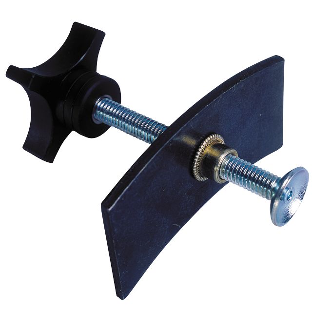

as far as a brake compression tool goes i just use a 2x4 and c-clamp, if you tighten it down all the way before putting the caliper on it works just fine. at least as far as front brakes goes, not sure bout backs, never done them before.

I believe the brake compression tool is cheaper then the c-clamp.
http://s7.sears.com/is/image/Sears/00947365000
$10 at Sears.

the c-clamp may be more expensive but i already have one so it didnt really cost anything. if you dont have one go for the cheaper i say.
