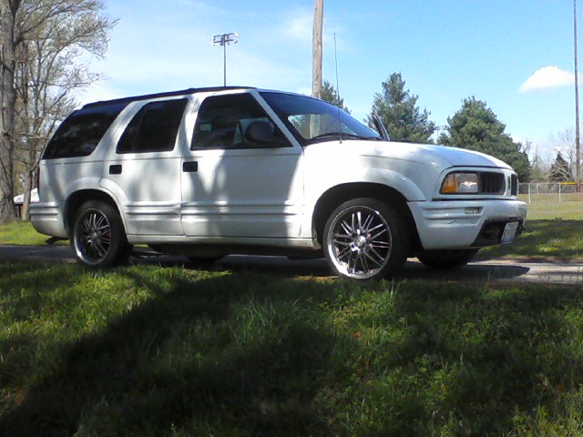

A pic of my truck..

nice bravada by the way.
