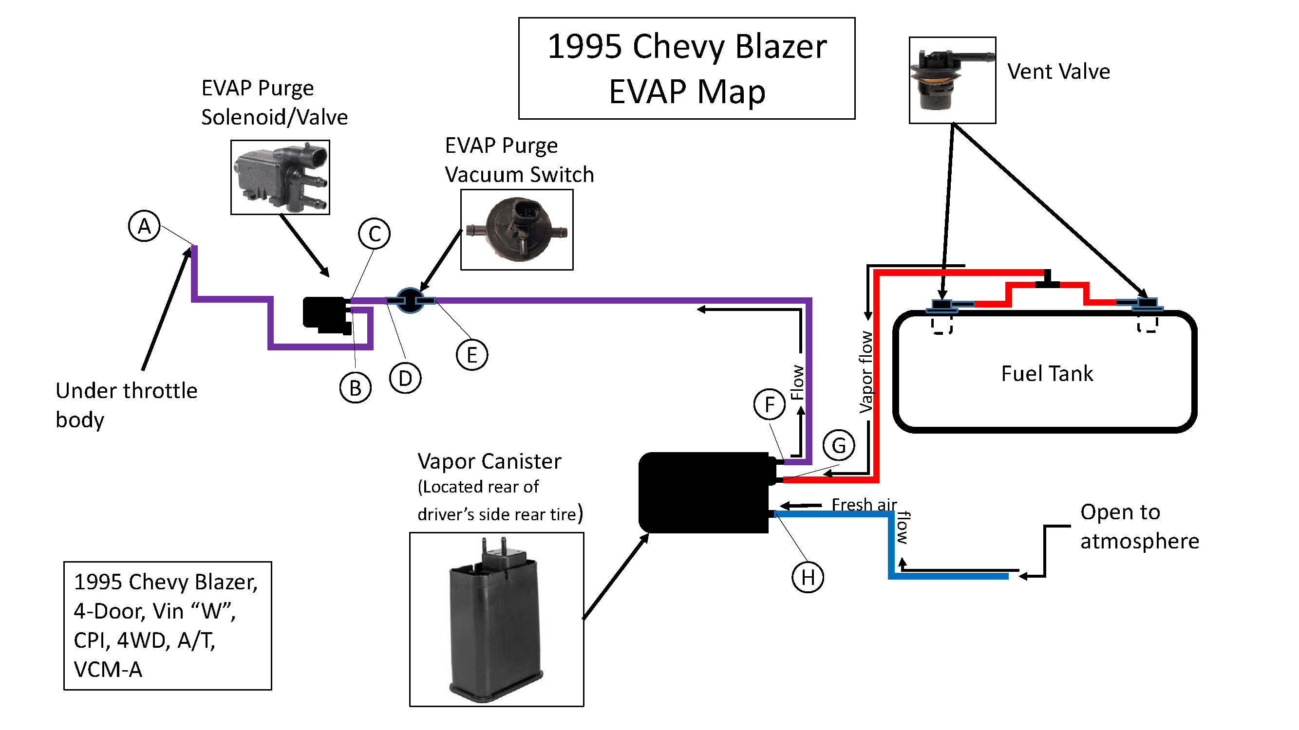

Here is the diagram I've been preparing for the leak tests. The instructions are pretty long an not finished yet. Did you get a MityVac?

That looks 100% correct from what I've seen. I haven't gotten a mighty vac, but if O'Reilly or autozone rents them, I can have one quickly.
Do any of the test procedures involve a bi directional scan tool? I don't have the ability to command the solenoids to open or close

No, I'm drafting the instructions so all you need is a MityVac, some vacuum line caps, and little bit of vacuum hose.
