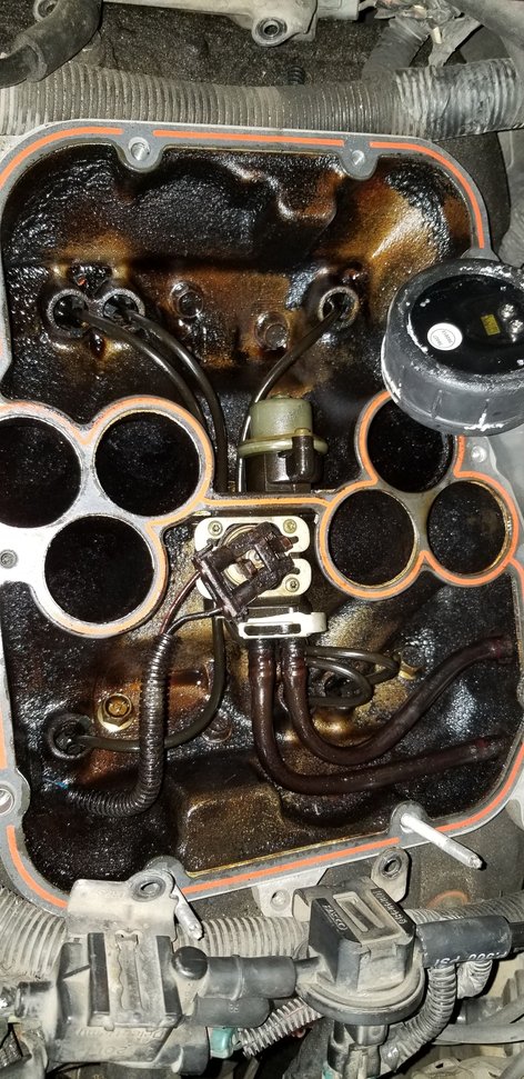

So, I got to thinking. This problem started after I changed the pump and injector. So I popped the plenum off. Looks like there's been some washing around each injector port, and under the fuel lines. But with the pump energized, there's no visible leaks at all.
With the pump running, fuel pressure is only like 52 psi, which I remember it being higher after I changed the injector. Also, it falls off as soon as the pump shuts off.
It still confuses me, though. Low on gas, it runs better than when it's full. If it's not evap related, why would fuel level make a difference?
Here's what washing I'm talking about. Seems like something is leaking, but I can't see where

Well fuel pressure is low, some reason had in my head you had changed that. I saw something when I was researching about a fuel wash and smell. But I can't remember if it was your engine or the other one. I'd have to try and find it. At the time I think I thought it was the other engine set up. Try Google, you'll probably find what I did.
