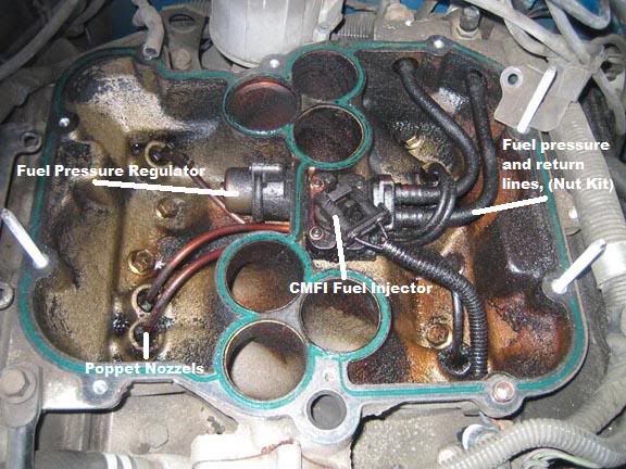

There's a combination of 10 bolts and nuts that hold the plenum in place. Pretty sure they are 10mm. Throttle cable, and some other minor things must be removed as well. You will need to replace the gasket, fuel lines, which are commonly referred to as the "nut kit", (no idea why) and probably a good idea to replace the injector electrical connector. With the plenum removed, ignition in run position, engine off, if there are any leaks, you'll see them. You might notice an amber or gold color where the fuel has 'washed" the area clean. If the regulator leaks, it will be "washed" on the passenger side. If the lines leak, it will be on the driver side.
This is what you'll see with the plenum removed:

Attached Thumbnails No power then dies and won't start!-lowerintakemanifold.jpg
