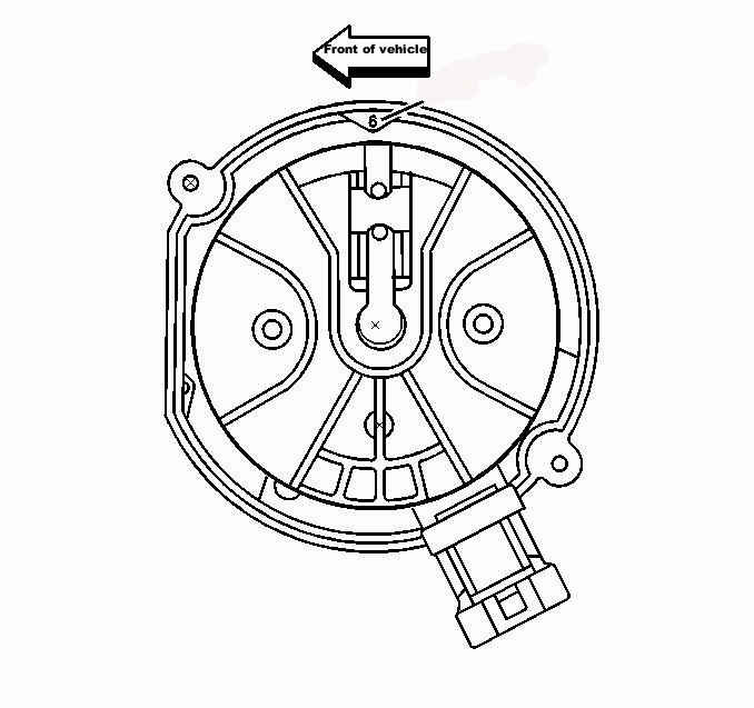

Hey captain are you out here? I need to know if I need to remove my distributor Lon my 1995 to get the lower intake out? I'm about to start working on it! Thanks

Yes, it must be removed. Disconnect negative battery cable, ignition in the OFF position, keys on the work bench until the distributor is reinstalled, distributor cap removed to expose the rotor: Using a socket and ratchet on the crankshaft bolt, rotate the crankshaft clockwise until the rotor lines up with the "6" on the distributor housing, then pull the distributor straight up.
The distributor shaft will rotate counter clockwise a few degrees before disengaging the camshaft gear. When reinstalling, make sure the rotor points to the "6" with the distributor fully seated against the intake manifold. No need to put #1 piston at TDC, provided you do NOT rotate the crankshaft, OR operate the starter, while the distributor is removed. Lining up the rotor with the "6" is merely a reference point for reinstalling.
