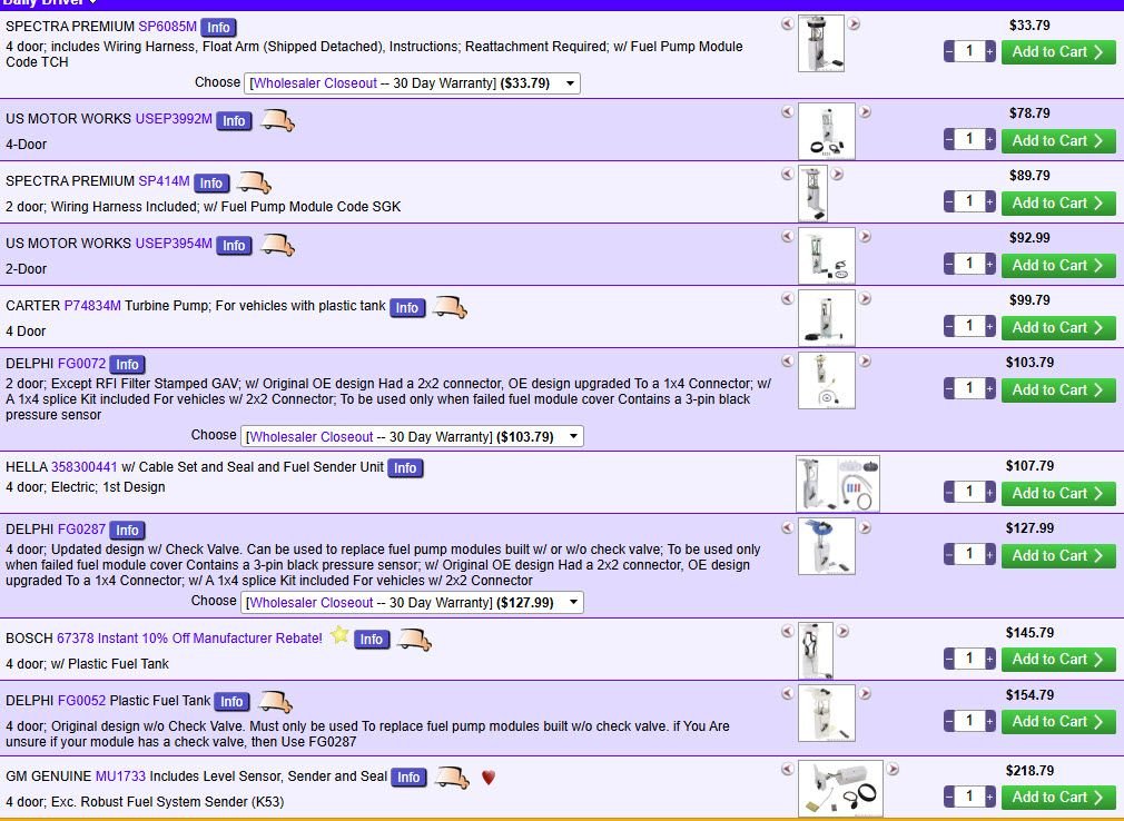

Here is a perfect example of GM parts vs direct manufacture parts. Look at the line up of available fuel pumps for my truck. Notice the GM fuel pump. Its mostly likely a Delphi rebadge. Hence why i bought the delphi and saved money.

The photo of your oil coolant lines is incredibly useful thank you. When I did the second fuel pump replacement, the dealer suggested whatever part O'Reilly had (not Delphi) because the fuel pumps are also discontinued, and after some reading I asked them do go with Delphi, which they did. Looks like I lucked out in making a good choice (fingers crossed!).
