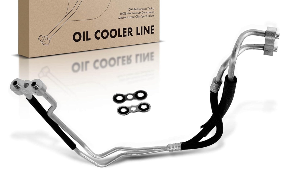

Look at this picture (not the actual part only as example) do you see the O-ring seals? Those should come with your new lines. Does not have anything to do with the oil filter, but the lines do connect to the oil filter adapter (fist-sizsed thing), So to clarify, your lines should include O-ring gaskets that go between the oil filter adapter and the line itself.

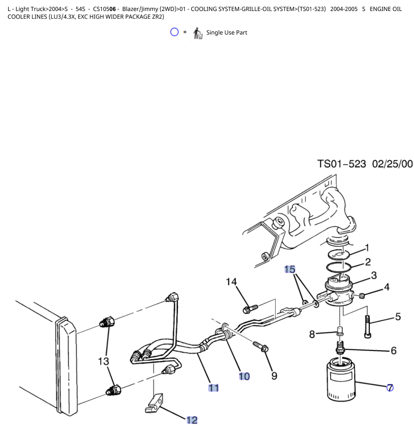

The Engine Oil Cooler Lines assembly part 15194577 is 10, 11, 12, 15​​​​​​​ in the below diagram on a 2004 Chevy Blazer RWD 4 Door LS trim. Are you saying to replace anything else?
