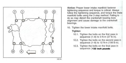

When installing the lower intake, make sure you follow the tightening sequence and torque specs. If it is not done correctly, it can do permanent damage to the engine:
Attached Thumbnails Oil tube removal on 96' model-intakemanifold001-copy.jpg
