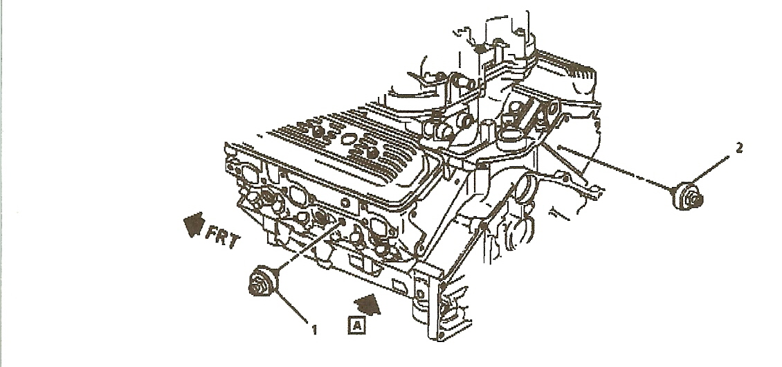

Hi. I have a 95 4wd 4.3 blazer with a knock sensor code and chceck engine light. I found the drivers side knock sensor, but cannot locate the passenger side. Anybody know where i can find it?

If you have the two sensor set up the temp sensor is right above the knock sensor on the drivers side head and the other one is on the rear of the passenger side head.
Attached Thumbnails Part location help-2011-01-17_033612_knock_sensor_location.jpg

Awesome thank you.
