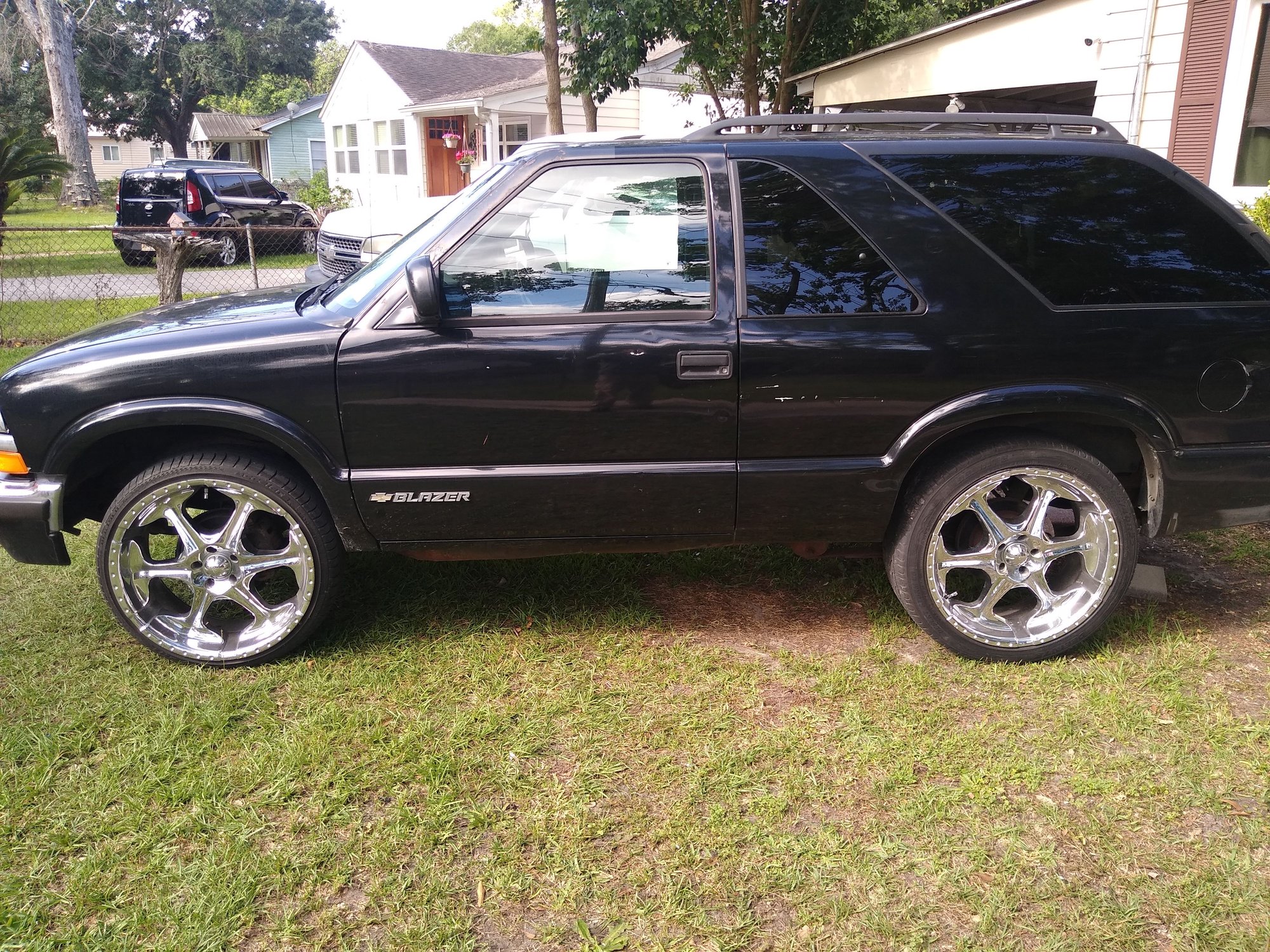

Well I've read all the threads I could on this code and still have questions... I'm getn the P0452 CODE ftp sensor connector voltage low or circuit open... pcm failure I suppose due to the po452.? Not sure. I've got a 99 blazer 2dr 2wd 4.3 vortec. Sat up for 4 years before I got it running and now use as my daily driver.. 153k miles on her . She's my baby... I seem to have always had a sluggish start with acceleration when first cranked since ive had her.. ive cleaned tank and replaced fuel pump and filter. She has never given me a sec of prob when starting up... never she idles like a purring kitten. I've replaced the plugs/wires, alternator, starter, fuel pump and filter, oil and filter. Installed K&N cold air and Flowmaster exhaust system. Replaced. The a/c compressor too. Sorry bout the lengthy post but just tryin to let you know where I'm at.. When I replaced the fuel pump I did not replace the connector that came with it cuz the previous owner had already made the switch. Am I going to have to drop tank again and replace fuel pump?
It's still under warranty from rockauto.com
Please share the knowledge... thank you.
