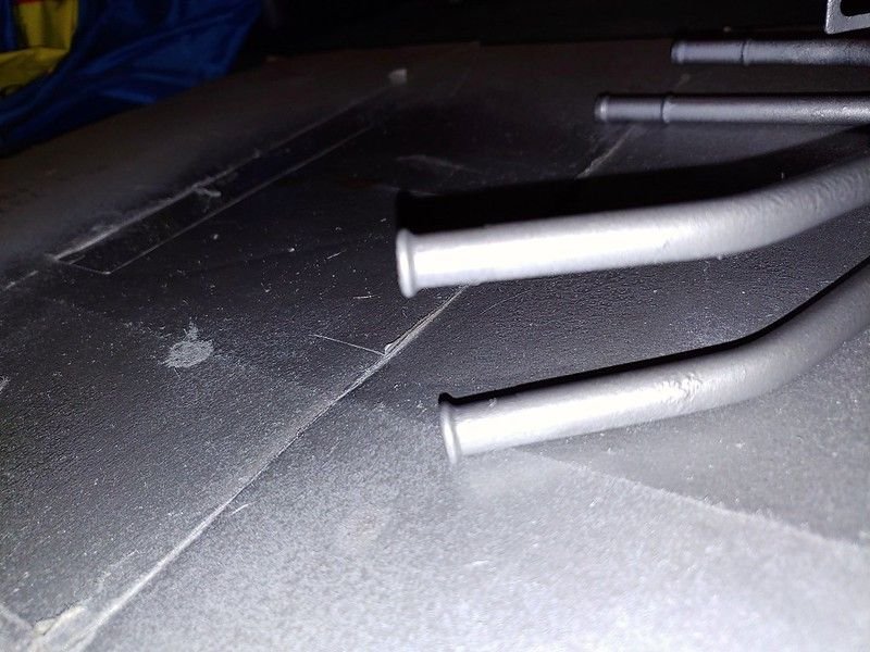

Here is the part that goes through the firewall. It had some surface rust. I sanded it with 60 grit and then did a heavy coat of primer and 2 coats of hammer finish. I might have gone a bit overboard on the flares, should be fun getting the rubber hose over them.
I have more pictures but Flickr links stopped working.

Now that Flickr is working here are the rest of the pictures.
I will post the rest in my build thread when I get everything done, if it ever stops raining.
