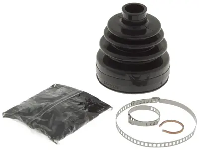

If the CV boot covers have only recently come off and still have grease in them, you might be lucky and you could actually clean out the grease, put new grease in and install new (and improved) covers. NAPA has the grease packets and boots. A C-clip retainer tool is required. Next time mine come out, I'll be doing this.

When I was looking for aftermarket CV axles, I could not find any that were not specified as any different than the OE ones. What was different was the boots. My original ones have a harder plastic boot and the new ones can come with a more flexible one. So I would doubt this will be an issue with any new CV axles as they will likely come with the more flexible boots. If you have a choice, go with the the more flexible ones.
So here is more detail on my experience: When I saw that the drivers side inner boot had slipped off, I gambled because I was in a rush and bought an aftermarket axle from O'Reilly's. But no matter how hard I tried, I could not get it in to the differential body. I then looked at the original one and decided that since the boot had only slipped off recently and that the original grease was still in there, that it was worth disassembling it to install fresh grease and a new softer boot. It has worked great since. It was also a literal 'snap' to reinstall.
I had a similar problem with the inner lip of the inner boot slipping off on the passenger side but I was able to fix that with a hose clamp. When ever I am underneath I'll do a quick look at all of the boots to see how they are doing and so far so good. The new boot has been on for 18 months with no apparent issues. I'm looking for an excuse to do the other side but it seems to be working fine.
https://www.napaonline.com/en/p/CTD6...wordInput=boot
