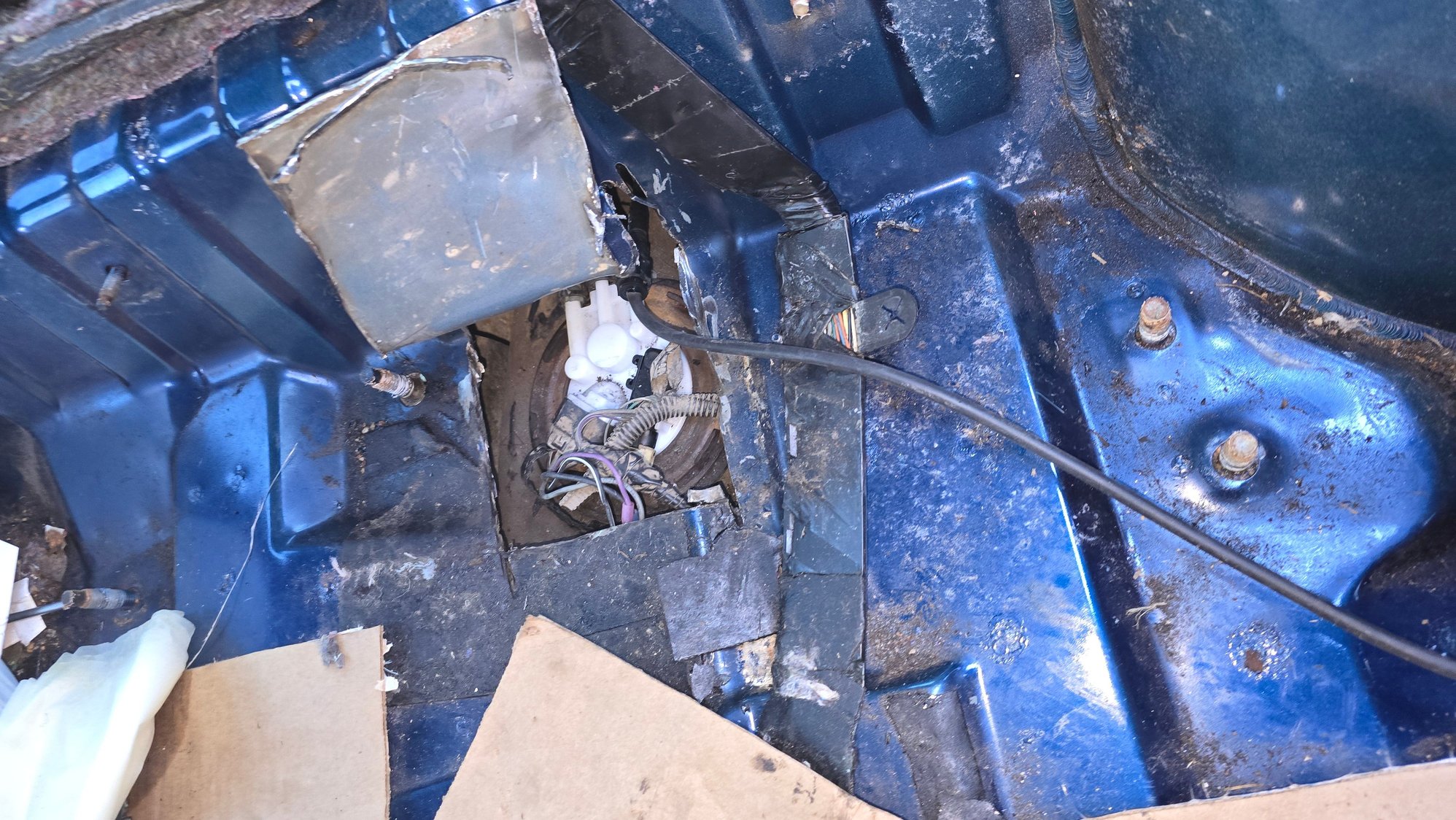

I realized I could use the same method I used earlier to test fuel pressure at the outlet side of the filter. It passed with flying colors. And I also figured out a way to pinch the return line using a handle little hatch the previous own left to make changing the fuel pump easier. Found it after I changed it the hard way lol. It's holding pressure great.
