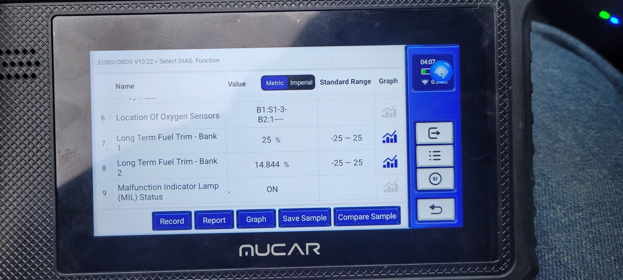

My grandmother recently gave me her 99 blazer that I've been trying to get for years. It has had a turn up. I keep getting code p0300. It has a light pop at idle and almost stalls after reving it. I look at the fuel trims with my scan tool and it doesn't look right

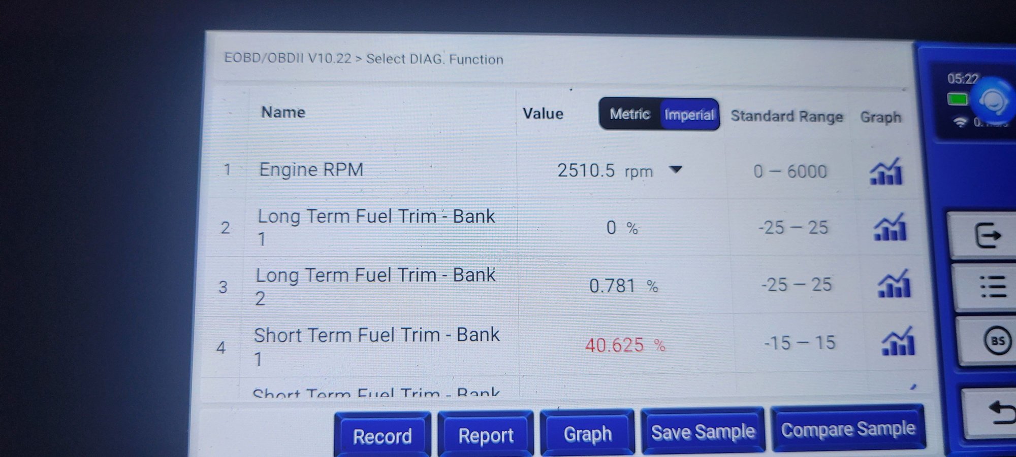

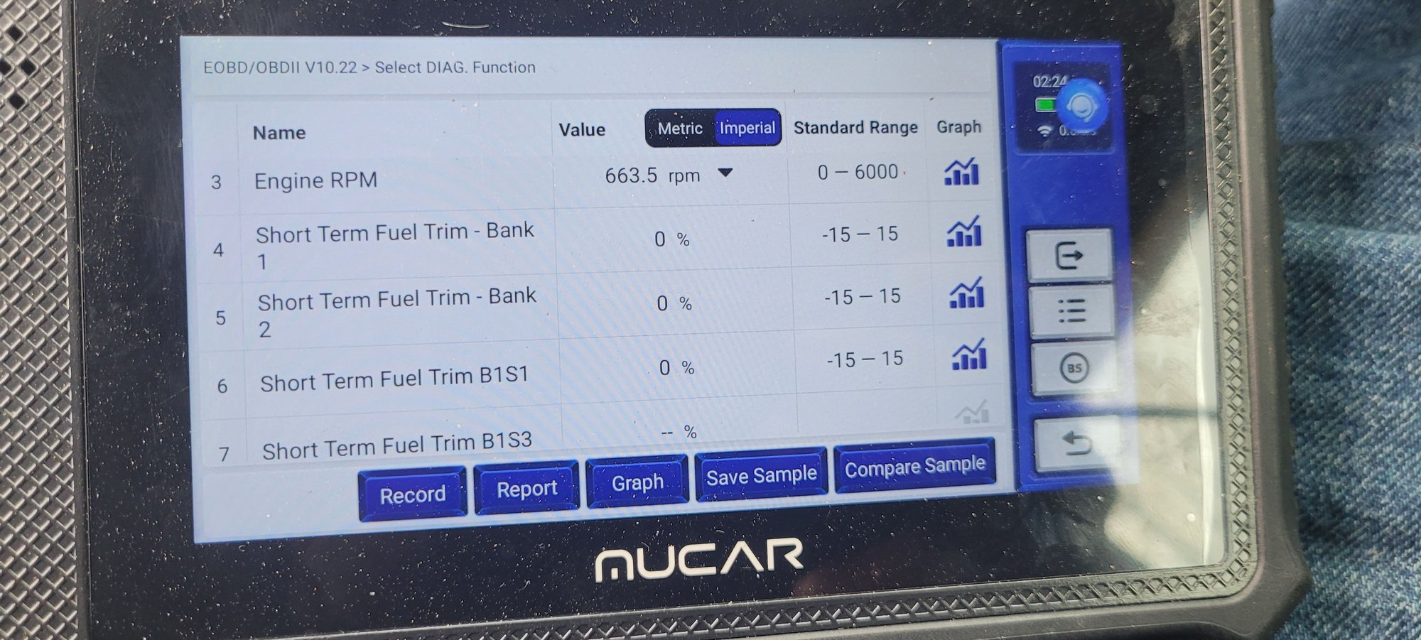

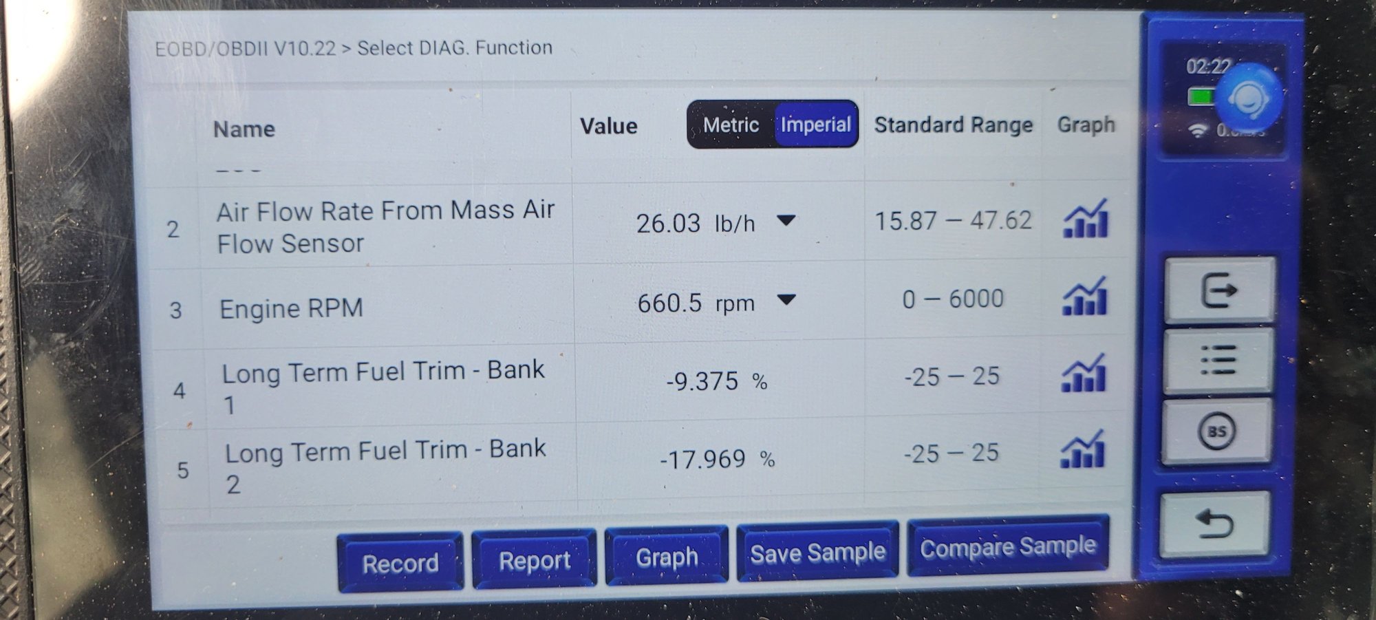

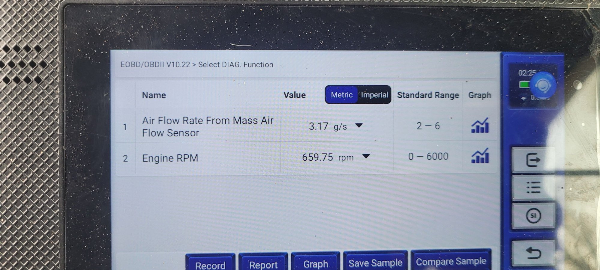

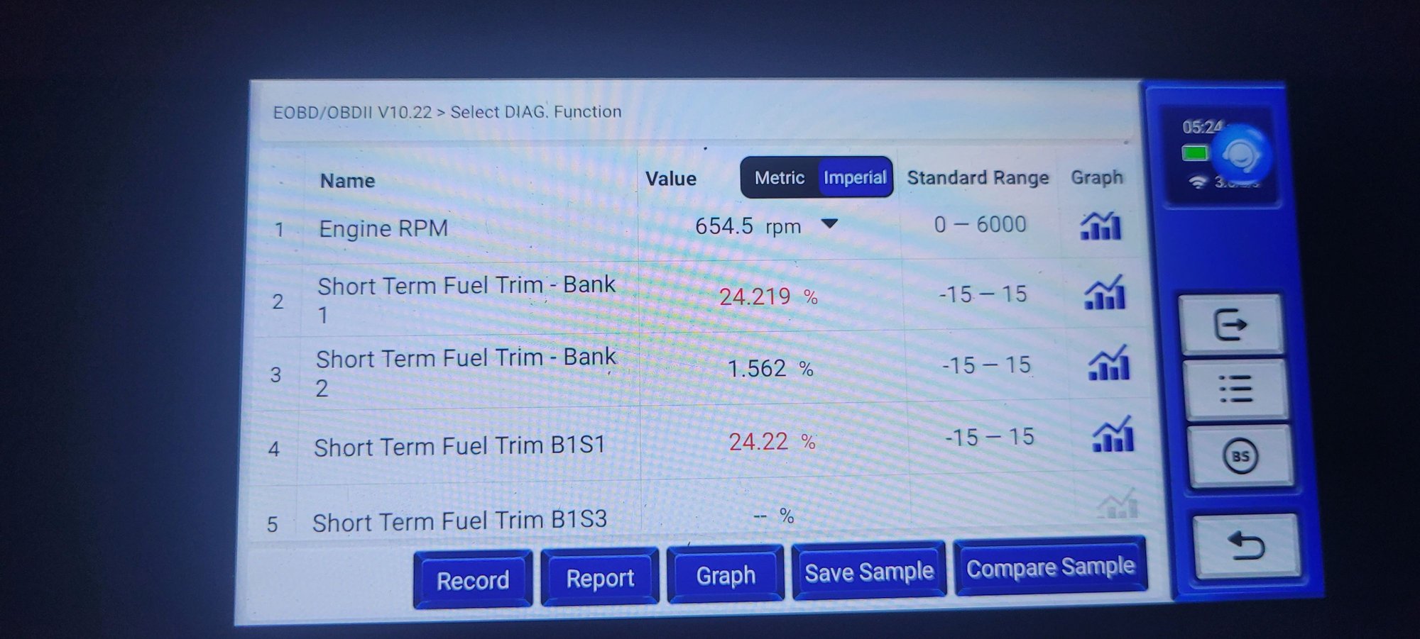

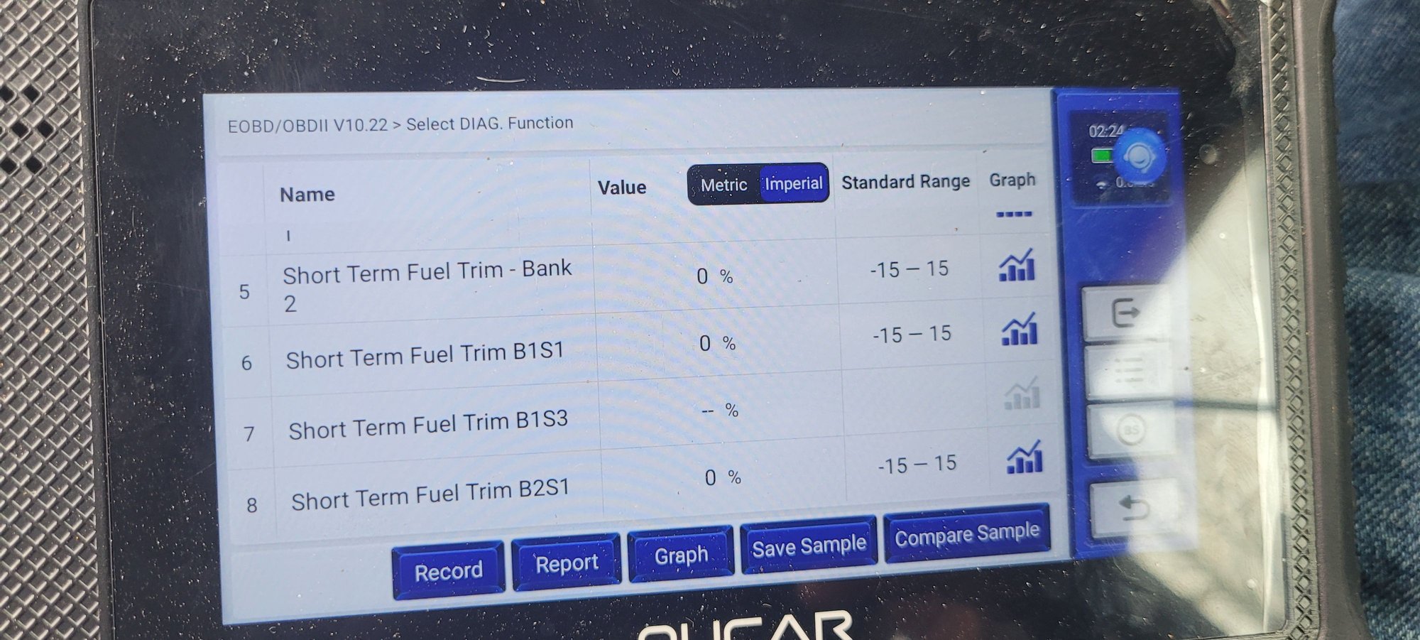

Here are the new fuel trims

These fuel trims are a mess. Are red values negative or out of bounds. IOW is every one of these values positive, even the red?

Yes they are positive. Red means they are way out of bounds. Scanner says normal range is -25 to +25
The O2 sensors are telling the engine computer to add fuel to the theoretical value based on sensor inputs, to keep emissions optimal.
  1. Check for vacuum leaks
  2. Check for intake leaks after the MAF
  3. Check for exhaust leaks
  4. On a cold engine in the morning grab the live data sensor values for ECT, IAT, Baro/MAP, TPS and the look up your local temp and barometric pressure
  5. graph your O2 sensors
  6. Perform the fuel pressure leak down test
  7. Measure CMP retard
George

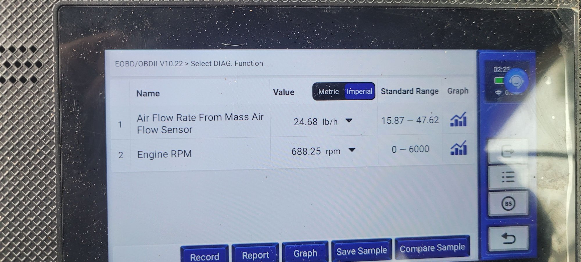

I change the distributor. New reading also fuel pre jumps to 60 then to 50 and leaks down to 40 within 8 seconds and keeps dropping. Also is the maf supposed to be giving a reading with the key on and engine not running

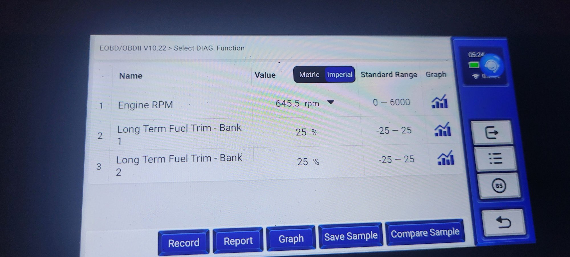

Its back reading lean again
