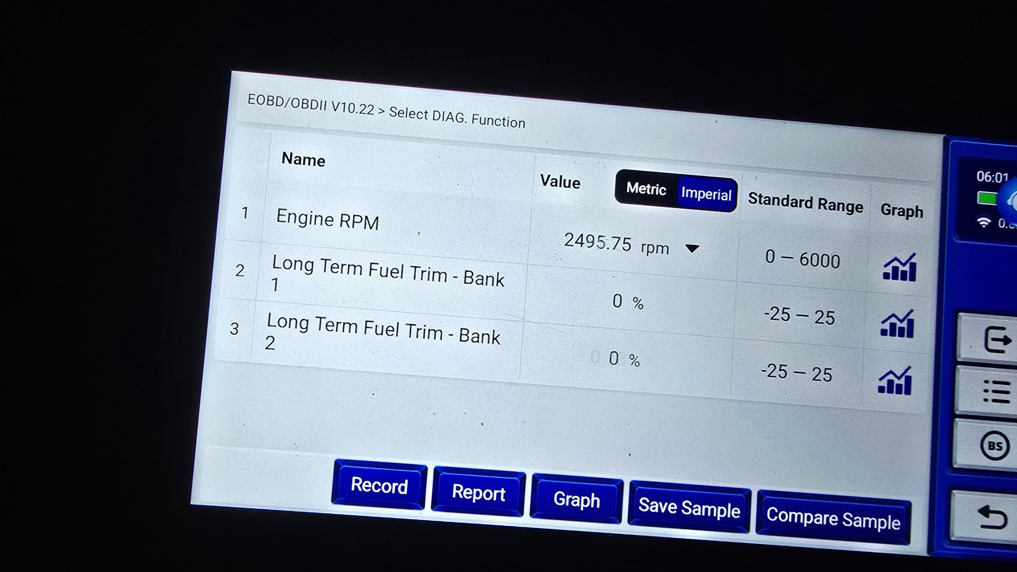

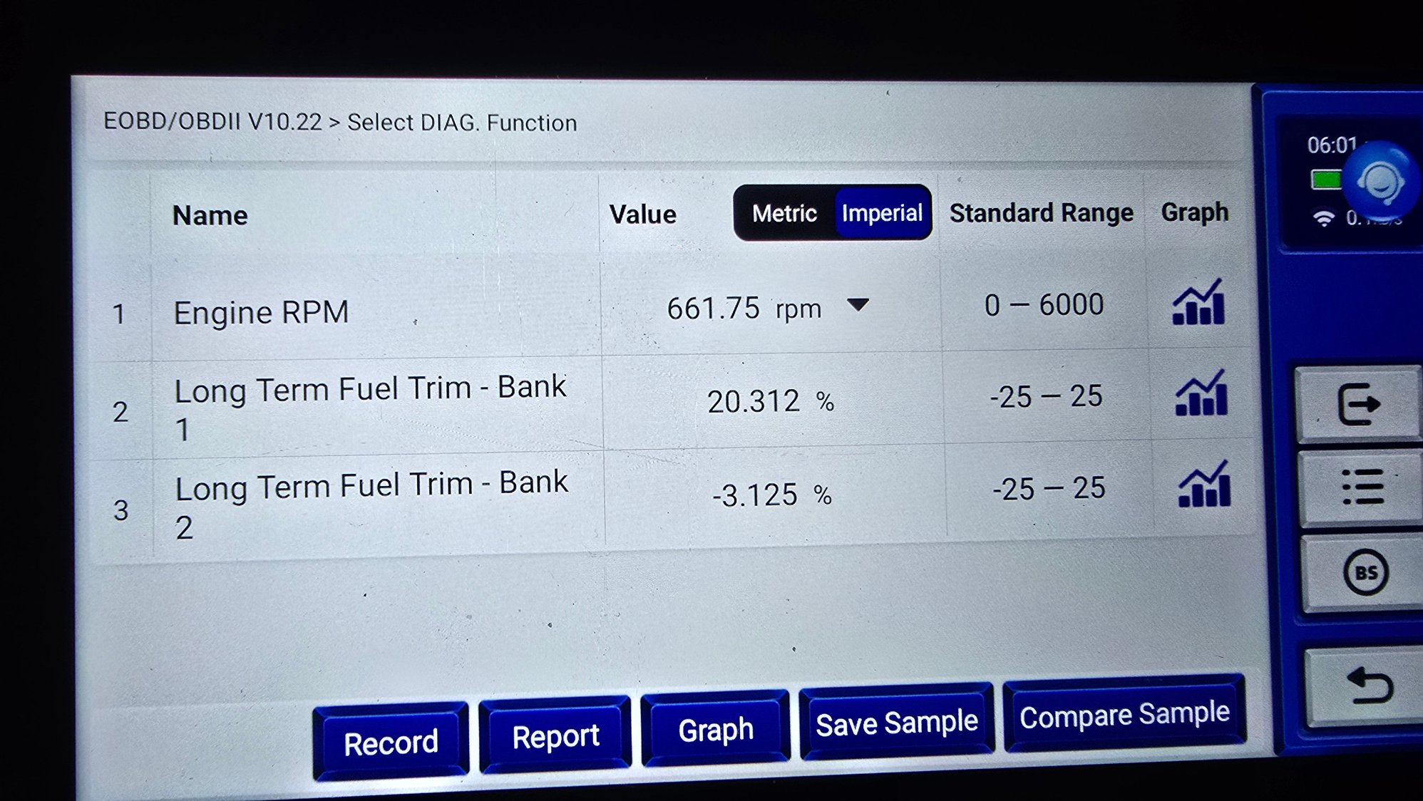

I think autozone just gave me a crappy one. Cheep one from ebay I ordered a while a go for cheap testing came in today. I installed it and it was the same so I adjusted it via the allen screw in the back of it to 58 psi. It holds but still get p0300.
Here are new fuel trims.
