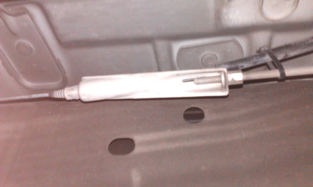

Have you backed off the length adjuster in the e-brake cable? Sounds to me like you're saying that your shoes are adjusted too tight and you have no adjustment left in the shoe adjuster, so have you tried loosening up the cable adjuster that is located along side of the frame, just below the driver side door?
