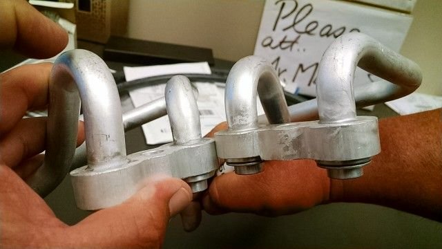

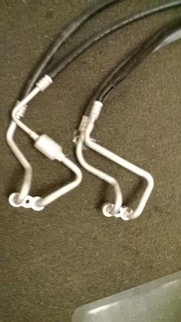

Default Redesigned GPD AC hose pn 4811526
So I've been in communcation with GPD and I got the following pictures showing their older and now newer design for the AC hose. This redesign has a lower arch for one of the rigid tubes so that there will be no interference with the underside of the hood and has no muffler which means it can be flushed if needed. Hopefully if you do your repair correctly, you will never have to do that though.
Here are the pictures:
Older design on left, newer on right.
Old Jun 29, 2018 | 10:40 AM

Old Jun 30, 2018 | 09:39 PM
Posts: 5,610
I got the new AC hoses from GPD yesterday. I sent them a quote to have it replaced and I'm hoping they will reimburse me for that cost.
In the mean time, I found a piece of wood with notch in it that fit over the tubing and I was able with it and a hammer introduce some more bend into the tube arch. This I think reduced the total height above the compressor by about 0.20". It might be enough to clear the underside of the hood and I was able to do it without adding any kinks to the tube. I put a piece of blue masking tape on the top of the arch so that I could easily see if it rubs against the underside of the hood. After a drive around town this afternoon, it all seemed ok.
