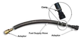

Ditto, piece of cake job. You can use steel line with compression unions at each end. You can also use fuel injection rated rubber line, but without ****** ends, I'd worry about the hose blowing off. 60+ psi is not serious pressure, but the possibility is there.

just make sure to use fuel injection clamps to clamp any rubber fuel injection grade hose
cap/ tape the end of the hose when trying to push into place to keep the crap out of it

rexazz, never heard of fuel injector clamps before. Just looked them up.
Thanks! They sure look better than screw clamps.

If I was stuck and had no choice I would use a gear clamp but we all know how easy it is to strip one of those
Also I think it is impossible to cut the hose with FI clamps no matter how tight you clamp them down
