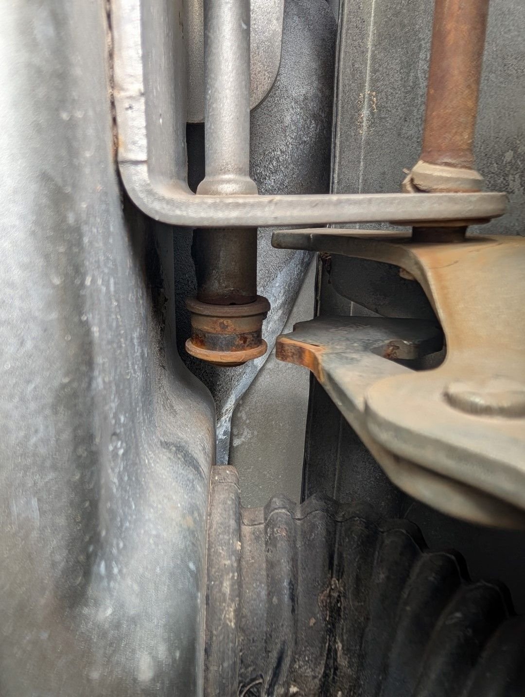

This is the bearing I am referring to. As you can see, I removed the spring temporary.
Rusted Right side Bearing no spring
Left side working bearing with spring

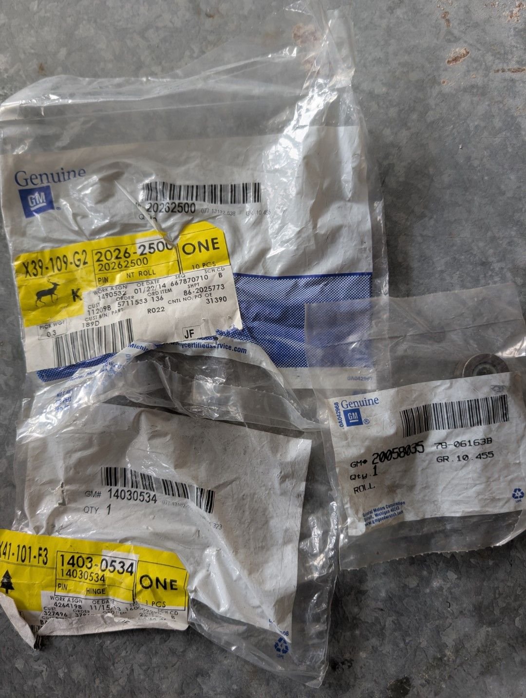

Parts are in!! See pictures for GM part numbers.
OEM part numbers
OEM part numbers

That's great! Thanks for the pictures and numbers. I have to fix one door as well.
