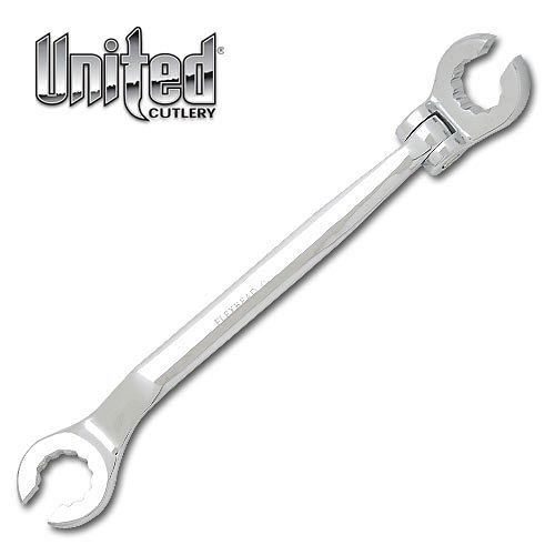

There are several styles of sockets with the slots, I was wondering which one. My sensor looks like this
I copied the pic from Abbyblzrxtreme . She couldn't get the special socket to work so she had to cut the wire and used a 7/8 to break it loose

That works for removal, but you still gotta get the new one in. So you'll need the sloted socket, or an open end wrench

If you needed or wanted too use a wrench why would you need to cut the wire, can't you just unplug it, and if you wanted use the box end slide the wire thu the box end.
Have you done it this way?
Yup - I also own the socket combo kit that Orielly sells for the O2 sensors
