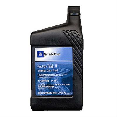

Your transfer case is an NV236, (2 speed selectable / automatic). The exploded view is on pages 50 & 51 of this link: http://www.areds.com/wp-content/uplo...se-CD-Web1.pdf
The Transfer case requires this fluid:

Hi all,
Thanks for the info!
I've changed the oil by the Autotrack II oil, so thats finished!
Thanks for the pdf link, however, I still wonder if the clutchpack gets it lubrication from this oil,( ATII) or is it completely sealed with its own lifetime lubricant?
It's hard to see it's "open or closed".
I also did the Dexron III job!
