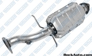

Funny, it turned out that I have a different implementation than the US versions have. I don't have any pre-cat, only the main cat. I will make some diagnosis to see if it actually works and then decide to replace it.
http://1drv.ms/1WBMdzx
EDIT: Now I realized that I have 99 model year and not 2001 as I thought. So now RockAuto lists the correct cat that should I use and it's only single.

Do you mean the universal ones or the Walker brand I listed above (factory fit)? The Walker is really not that expensive. I think I will pick that one later on.

the walkers fall under the cheap category. maybe you will get lucky but it seems like under most circumstances they only last around 2 years
