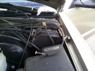

I found this vac hose plugged, can anyone tell me where its suppose to hook up ?

Yea if this is a 4x4 blazer it should go to a ball mounted on the hood unless someone got rid of the ball and converted to the cable style I've heard about so much lately on here

when you say ball, I guess you mean a vacuum ball ? converted to a cable for ?

no idea what toys talking about,but,that should indeed run to the "toilet ball" behind the fender.

behind the fender, ok... ill check it out. thanks chris...
