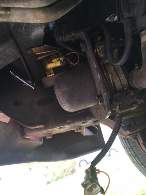

Tested the Fuse next to the battery, both 10 and 30 are good.
Got the bottom panel off, and have loosened up the Pump to disconnect electrical connection. I could never really tell if pump was turning or running, even with help. Is this a 12 Volt Pump. Should I be able to supply voltage to the connector and hear it run if polarity is correct?
Another thing, since this looks to be original equipment it has clamps holding the hoses in place that seem to be ONE TIME USE, so if I was to try and remove the pump to see if impeller is turning etc, I am not sure how to handle the clamps.,
So if I supply voltage to the pump and it does not turn, I would replace pump. Then I understand there is the Air Hose which seems to run up towards the battery and end is cut at a 45 degree aiming straight up and open to air. They say that should be replaced. And I understand a ONE WAY valve or two? And relay etc.
I have that flow diagram, telling what to check etc. I really need to get a CODE CHECKER that will perform some tests, as well as just read the codes.
So do I add some voltage to the pump, or buy a OBDII tester that will turn pump on?
Attached Thumbnails When is car tuned correctly to replace Catalytic Converter?-secairplug.jpg   When is car tuned correctly to replace Catalytic Converter?-secairconnection.jpg

A bidirectional scanner that can operate the pump is $1K or more.... for a used one!
If you apply battery voltage and ground to the pump motor, it must run.
Lineman's pliers, or diagonal cutters will do the job on the "one time use" clamps. Then use the worm gear style hose clamps.
Should be one check valve in each of the two lines to the exhaust manifolds.

Applied 12 Volts from a charger directly to the leads to the pump. RED to RED, etc.
Nothing, pump never came on.
So I will order a pump thru Amazon Prime, is there anything else, I see some come as a KIT with that extra hose that sticks up in the air, with a Cap that prevents water from rushing down as it points up to get air. Car now lives in Southern California. Nicer weather, than Oregon it came.
Could I just get away with the pump, or are there any other parts and should I go to Rockauto for those one way valves, which I really haven't located. I did follow this 1/4 inch hose that looked new all the way up the passenger side of the vehicle and over the top of the engine to a hookup for suction, I would guess. Thin hose must be 3 feet long.
Thanks….. Maybe I should check and next cold start if there is voltage to the other side of the connection?

There is a GM TSB that improves the hose routing etc. Maybe a Google search would find it, can't find it in my stack of stuff
Wouldn't hurt to check for power and ground at the connector with the pump unplugged.

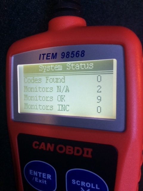

Well thats the final result, after I replaced the Secondary Air Pump. I kept seeing the OEM Delcos on Amazon, but by the time I was convinced to order they were back ordered. Price went up $10 as well. So I ordered the ?Cardone, that just comes with the motor, and you replace your plastic cover to where the hoses go. I did that and after getting a code that says the drive side one way valve could be a problem, I decided to reset the codes and do a drive cycle. All the codes eventually went away when testing condition for code was reach.
And yesterday I replaced the Cat Converter with a Direct FIT California Approved MagnaFlow Converter Part No 447212.
I had in the last few weeks sprayed all bolts with pBlaster that I see recommended. Saved a ton of money doing it myself, but I have the aches and pains in this old body to prove it. Tightening those bolts even the new ones, needed a lot of arm power to bring to a tightened condition.
Now the vehicle is still worth $1200? but no more rattle. The old Cat rattles like a tin can inside. I know that don't pay as much for rattling cats. Will shop around locally in So Cal to see where I can get best $, or not
THanks, for all help, Now I would think it would pass smog easily. Even though it won't need it for 2 years, or if we sell

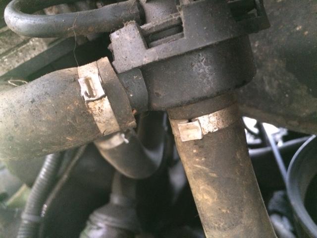

Well since the above work, it will go about 3 weeks, then I get the P0410 for the secondary air. Then I reset, and 3 weeks later get it again with the P1415 the one that says the ONE WAY VALVE on the drivers side is bad. So I replace it. Reset codes, and after 2 or 3 weeks get the SES. Its P0410.
So how do I test the Vacuum Switch that runs around $27. From What I have read, that may cause the P0410 Code. I guess this is the switch with small hoses attached down where I replaced the secondary pump, a few months ago.
Or Maybe its that big valve that I have a picture of above??

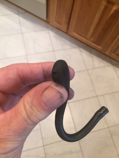

I tested the Diverter and the Solenoid with a vacuum tester. Diverter worked as tested via this great DIY on youtube. But the Solenoid acted just like a new one at the parts house when vacuum applied. However just prior to testing these two parts I discovered the small hose from the solenoid to the diverter had a small hole in it. Probably wouldn't hold a vacuum. So prior to running the tests on the Solenoid and Diverter I replaced the hose for .50 and the SES went out. I reset codes and lt hasn't lit up again in two weeks
Not sure why Solenoid didn't act or hold vacuum in test. But only Pump, One Oneway valve and a .50 hose to fix, so far.

MY HOSE:
