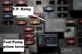

The fuel pump may have been jarred from hitting the rock. With the ignition off, apply battery voltage to the pump prime terminal, in the underhood fuse panel, and see if the noise is still there.

Ok did that and i hear the pump go but no whistle like i heard. Is there vaccum lines up around the tank ?
