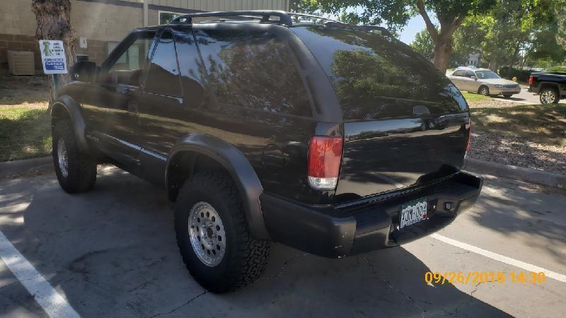

I just picked up an old set of the aluminum Blazer wheels for $25 each and stripped, cleaned and re-sprayed a lacquer coat on them. Wrapped them in the BF Goodrich all terrain KO's 31x10.50x15's.
Rides like a dream with the new tires.
And yes, I removed the spare tire carrier from the back and found an inside mount at a junk yard for $15. Found an all matching black tail gate for $75 that does not have the bracket on it as well.

Looks good, nice and clean... I come across the interior spare tire holders a lot. How does it hold up? How big is your spare? What did you do with the side holes?
