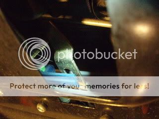

With the trim panel removed, you can see the broken blue clip and the metal arm rotated up into its normal position.
Also, note the bar that the metal arm is resting against, that is what the actuator and metal arm hit to open the window. I think that is what the guys with the large allen wrenches are hitting and getting the window to open.

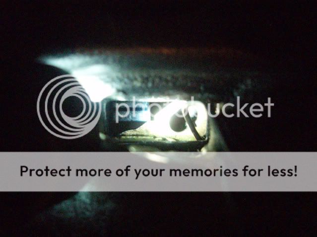

This is what you can see through the access hole in the trim panel when trying to fish out the metal lever.
With the metal arm held up with a piece of wire I could now insert a screwdriver to the right of the metal arm. Pushing the handle of the screwdriver to the right pops the glass.
